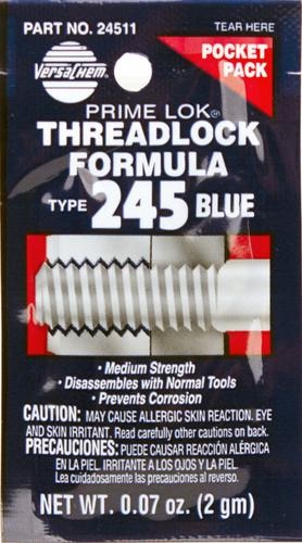

As for securing that nut, auto parts stores do sell small packs of thread locker, under two bucks. That way you don't need to buy a $10 + bottle that you might rarely use.
