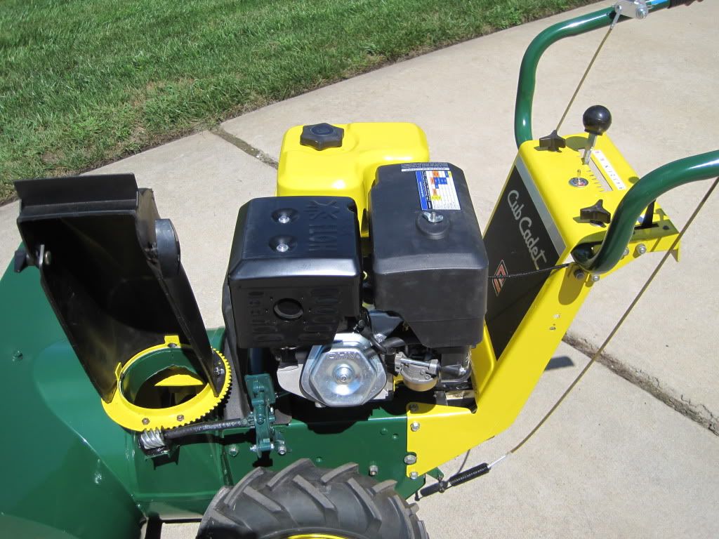

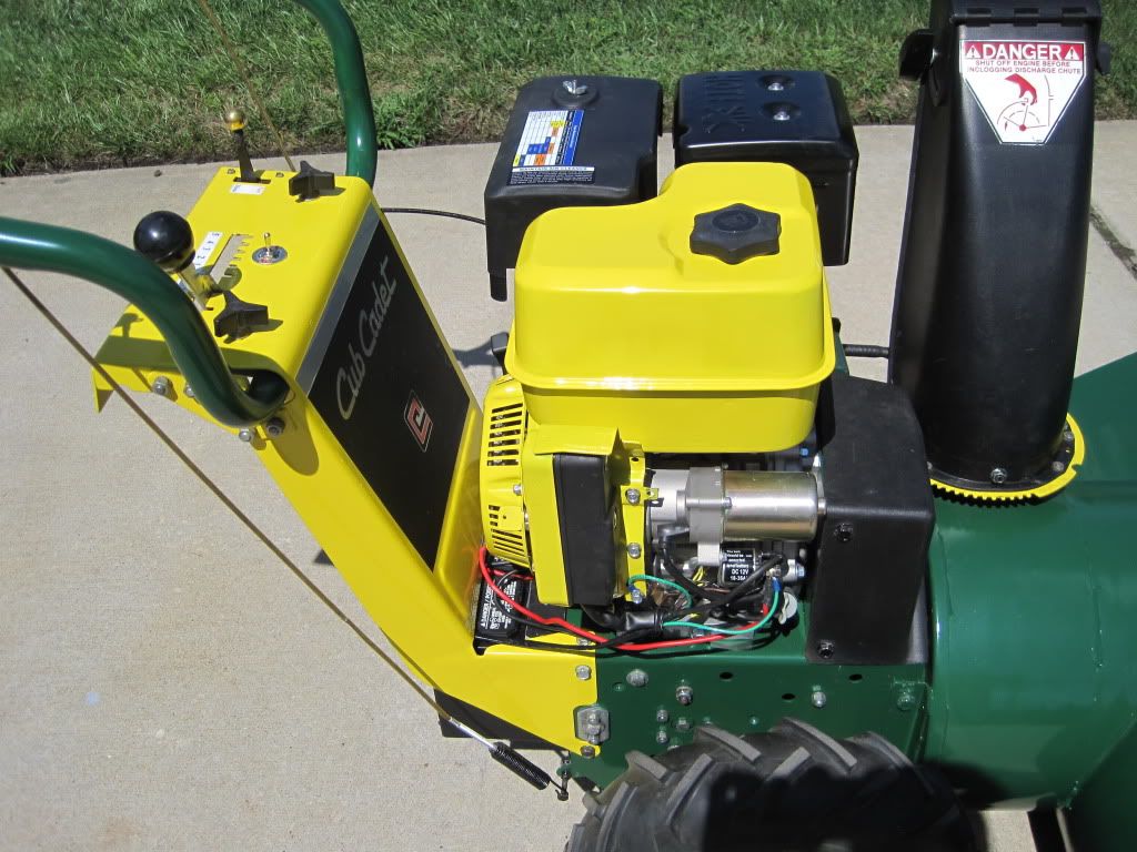

I put the 340cc 11hp greyhound on an 1983 Cub Cadet which has a very similar handle setup as the simplicity, except even more enclosed

Carl... that's a sweet looking machine. Was this the factory color scheme or did you change it ? Looks very nice.
I changed up the colors. the factory colors were cub cadet cream and yellow and the tractor section was black.
