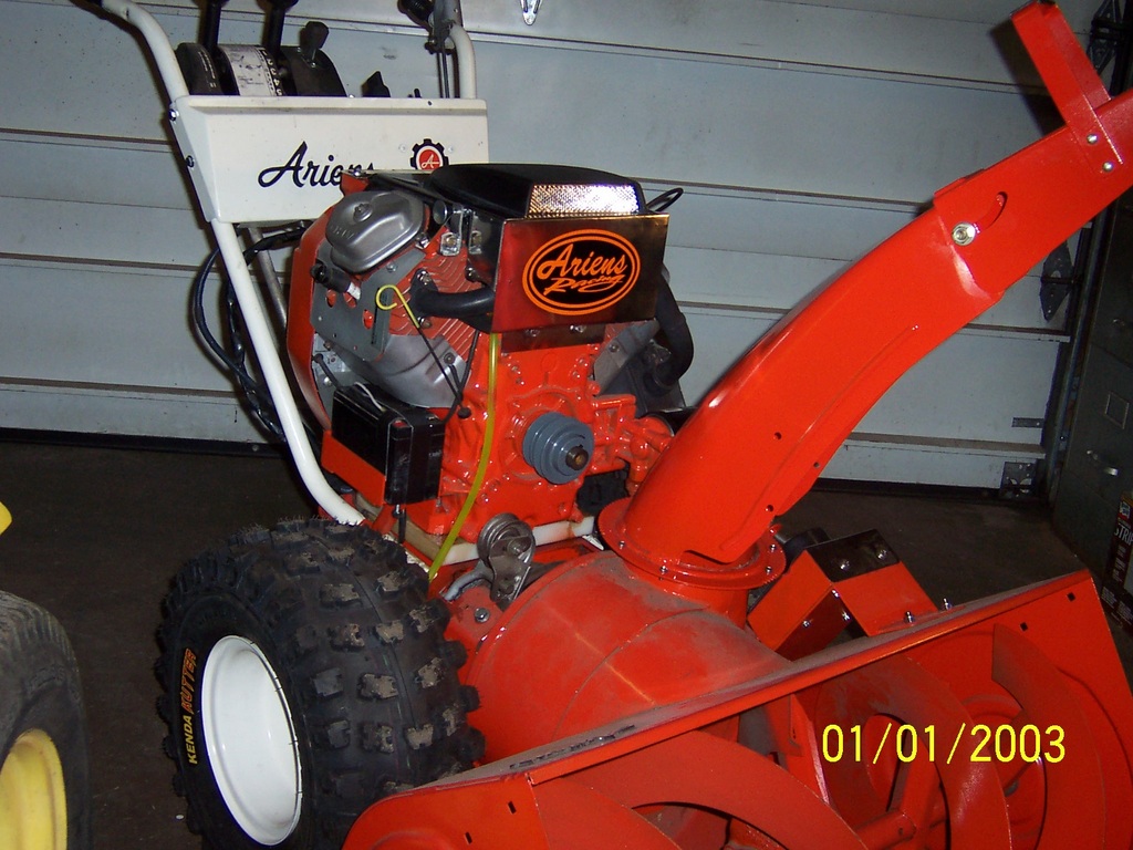

There are plenty of options from the crazy (diesel) to the crazyier like the 22hp twin cylinder of Geno's to the more normal being a 6.5 horse Harbor Freight Predator at $99 to $129 depending on the sale.

This is a photo of Geno's 22 horse twin cylinder Ariens.
The craziness is only limited by your time, ability and wallet.
