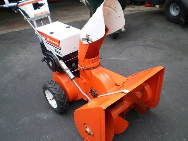

You can do it at the very bottom of the chute, you could weld a small "u" channel around it (possibly a small square tube cut off in the middle, or just two small plates to hold the cable in place).
The above will work if the chute of your machine looks like this

It is exactly the same blower that I have. As you can see at the height of the gear turning mechanism of the chute is where I have space to put the motor but before I want to change the model number to Ariens 1530DLE by switching the engine.
