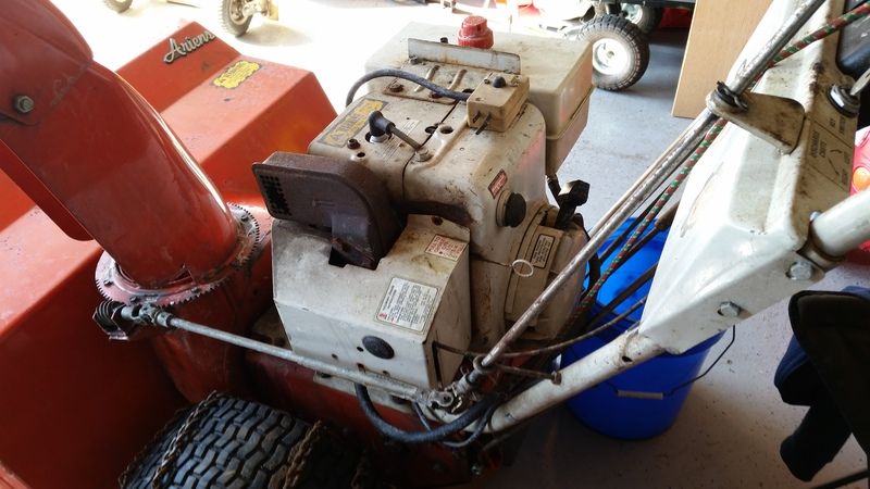

here's a pic of the chute crank with the original motor

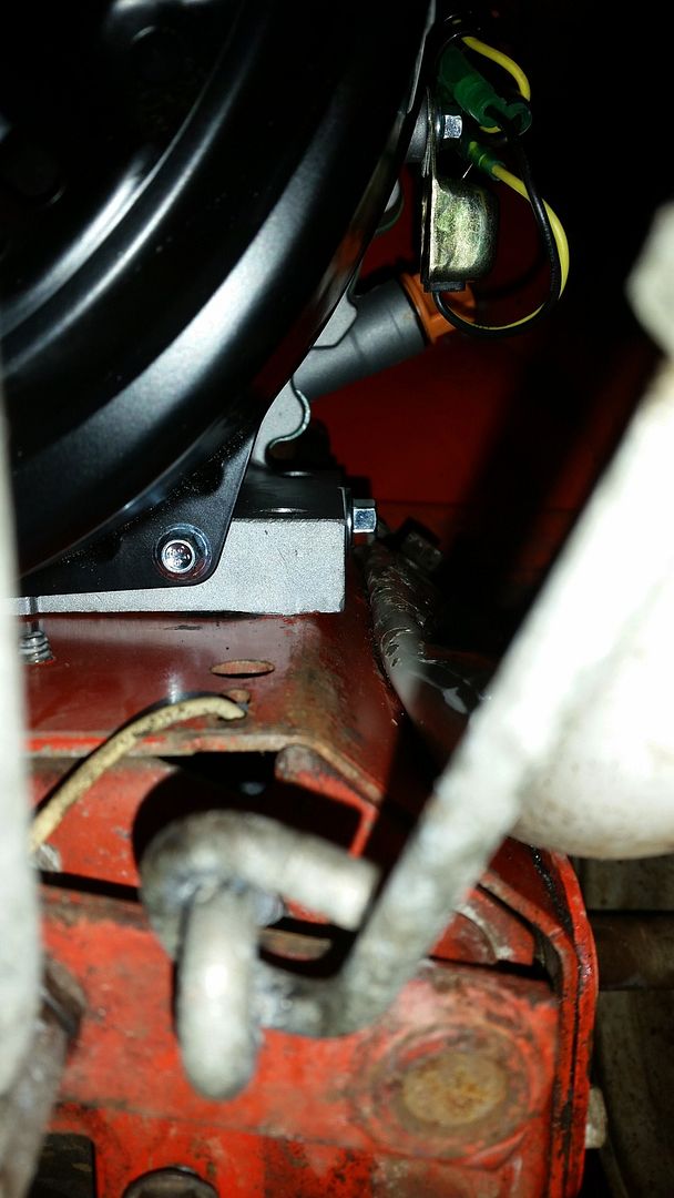

no. as you can see here not accounting for where the crank is sitting, there is a small amount of overhang. If i line up the crank with the old position, there is even more of an overhang to one side.

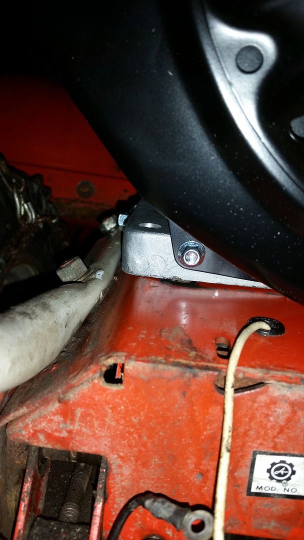

and the other side. again, just having the engine centered on the base plate.

I only did this with the smaller 212cc, but as for chute control, maybe if you shorten that eyebolt it will bring it low enough? I also had to trim the plastic covering the carb. You will probably have to change the length of the rod/rods but with two universals you should be able to place it in a easy to access spot.
