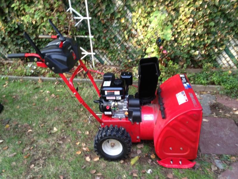

I have a 2008 troy bilt , 24" model 2410 snow blower and the engine is defective. What do I have to do to mount the predator 212 cc Harbor Freight engine?

I am still trying to save the present Powermore engine. I was blowing snow last week and it just stopped and would not restart?? So, I have done the following to no avail, changed gas, checked the valve lash, ok; pulled the tank filter,ok; cleaned the carb, ok; put on a new carb; changed the spark plug, it had a weak spark, tested it with a plug checker; put on a new coil harness, lots of spark; pulled the head to check lash, push rods and valve seating. I am putting it back together now?? any ideas

Well, the snow blower is running today. After all of the changes the issues was the Valve lash was too tight on the intake valve. I opened the intake valve lash another .002 to .005 and it took off running with no surging issue. I guess this Powermore engine is very sensitive to valve tolerance??? Still seems strange that the Snow blower was running when it stopped for this valve issues? But I will take it. I put my baby in the yarding storage shed until November 16. Thanks for your input.

Might have been the weak spark that killed it and later the lash that prevented it from starting back up
Just in case you do need to re-power Storm2410 did a great job installing a Predator on his. Said he was able to use all the hardware only needed to get a 7/8 to 3/4 adapter off ebay.
Looks like OEM.
