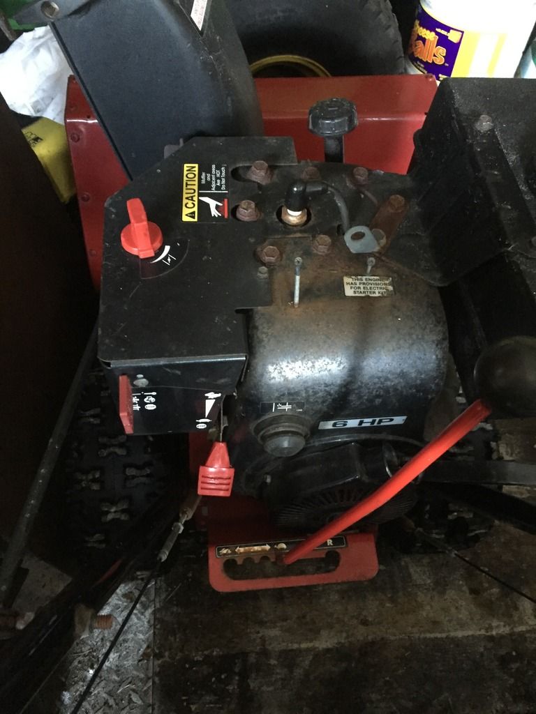

Ouch, that's a bit $$$ in my opinion, mine IS the 6hp and one a few differences are the choke knob is on the top and all the 5hp had it on the side or the engine, another thing I noticed is the starter motor is larger than the 5hp starters. Post some pics when you can and we'll see what's on it.
Dauntae is online now

Okay...finally got my blower home today. Looks like it was made in 1990.
The guy at the shop claimed he had to call Tecumseh for some parts, and gave them the serial number. He said that that model year (89/90) they made a mistake and used some 6HP blocks that were meant to go with 5hp engines and that my engine was one of those. The top end still looks to be 5hp though, so i'd imagine it's 5hp, even though this guy seems to think it's six.
He changed oil, something to do with the ignition (said flame was orange, and needed to be blue, greased everything up, cleaned the carb, and did a bunch of other stuff.

Looks good, I think mine was from around 85-86 if I remember right but you can see the slight difference in the heater box.

So what's the consensus from my pictures and story from the mechanic. 5 horse or 6 horse?
