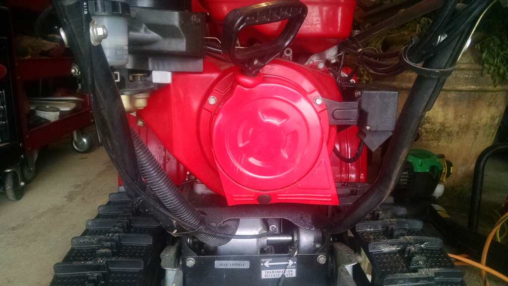

I have the first generation 828 (not K1) and there is a third bolt at the bottom of the starter case that you access behind a small black rubber plug.
I see Robert's drawing has it, but the text says 2 bolts.
If you have this, you'll need a 10mm deep well socket or a 10mm wrench and slip it up under the outer case.

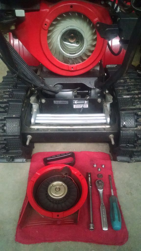

Three bolts, off in less than a minute. First run HS828TAS.
