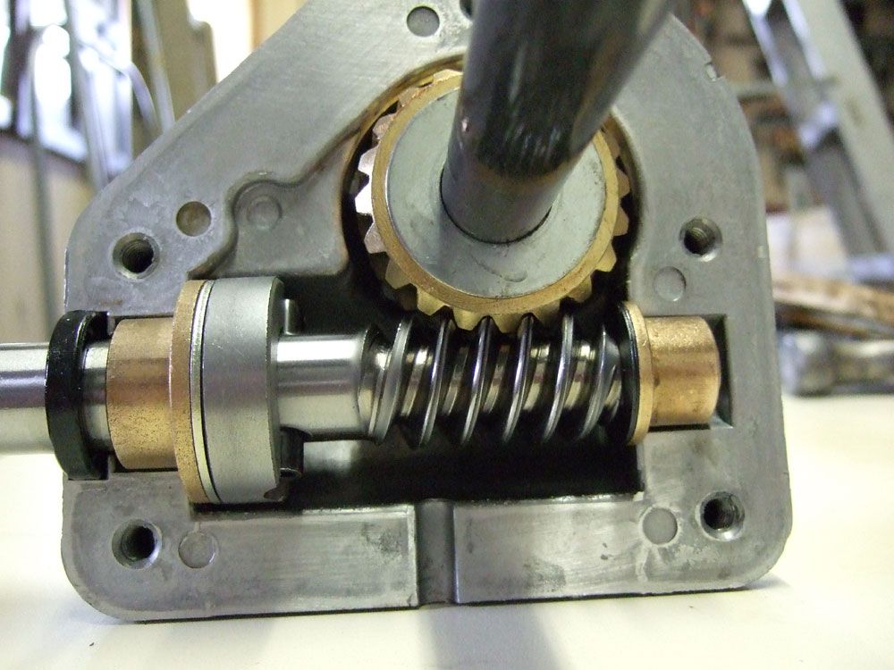

This is a pretty standard MTD machine and the gearbox appears to be identical to this one:

You'll have to pull the assembly out of the bucket. Not as hard as you might think, just gonna take a little time. GL
