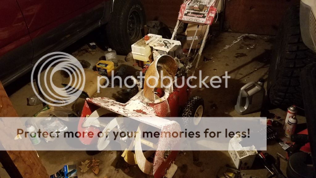

I have a 1980 (going from the plastic carb float) Dynamark 8/26 that I've been going through. Seems like a well built machine, although the control mechanisms are a bit more involved than my other old Ariens. Getting ready to put the finishing touches on, it's currently up on the auger to change a belt, and thought it'd be nice to change the oil in the gear box while it was exposed. I don't see a clear drain or fill point though, and I had a...memorable...experience removing the wrong bolt on an unfamiliar trans to try to drain it one time so hoping someone else knows what's what.

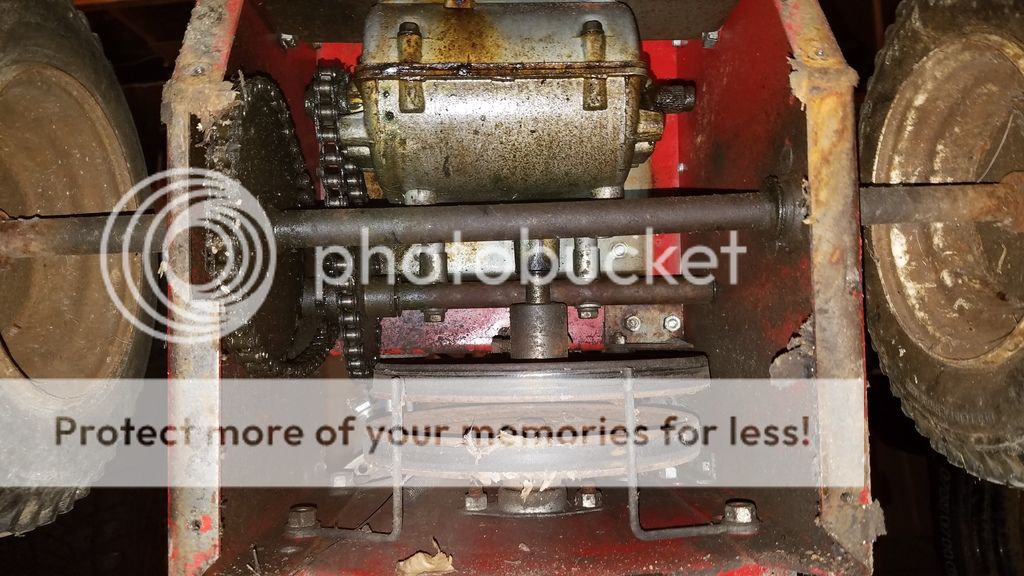

Underside from straight on:
Right side:
The grooved/knurled piece looks promising. Bolt at read has a mirror image on opposite side so was thinking it hold an internal shaft in place.
Top/straight on:
Large bolt at top and small allen bolt at front maybe? But where would the drain be then?

For future searcher's reference - last pic, large, low profile bolt under the gear is an oil fill. Gearbox needs to be in neutral for the hole in plate underneath to be exposed, don't move plate or you'll shift and throw off gears. Lining them up after is enough of a PITA as it is. Need to remove trans support to access. This case was bone dry, filled it 1/3 - 1/2 with 80w GL4. Greased all points underneath and closed up.

I like this machine, it's front-heavier then the Ariens so stays tight to the ground with less work and the gear ratios are better/lower, and reverse is a bit higher. Shifter is smooth as well, though fussy with positioning. I don't like that as soon as I release the drive lever the auger stops turning. Given the engine issues I'll probably go over the Ariens quickly and make that my primary.
