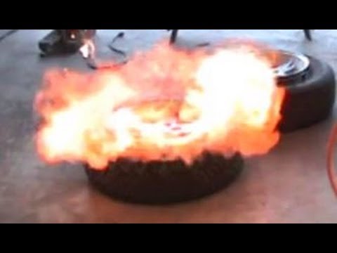

I'm scared just hearing the description of using a "moderate" amount of starting fluid. With a smaller lawn and garden tire I can't shot in a small enough amount. It barely takes any spray at all to get one of those tires to pop out and seat. Once it seats it self extinguishes. I understand the idea behind taking the valve out of the stem but in all my years of using this dangerous trick I've never pulled a valve and have always needed to add more air after it's popped out and seated.
This isn't the safe way but it's quick and easy.
Usually I'll take the time to get and use a ratcheting strap to try and seat the beads first. Mush safer way to do it :-)
If you chose to try this method by all means wear safety glasses and remember it's always easy to spray a little more the next try rather than use too much the first time (like in the photo).
