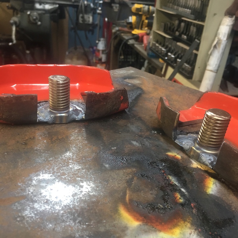

I was having issues with shoes grabbing my uneven hot top, i made up these shoes with sealed roller bearings. My 36" machine now rolls effortlessly over my bumpy driveway.

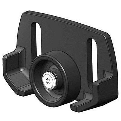

Your creation certainly looks similar to these:
