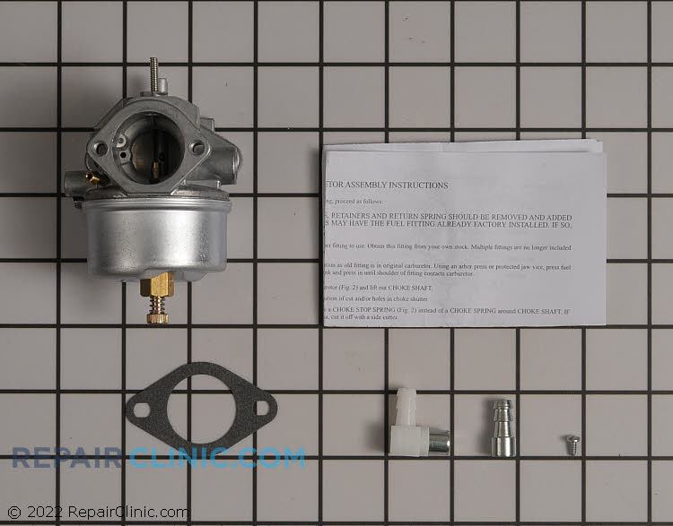

Hey guys. A buddy dropped off this old sears SB and it needs a new carb. It sat with bad gas and its trashed.
I tried looking online and cannot find anything on this machine that shows the carb. Its a tecumseh engine but I can't find much on it either. Tecumseh 143-686092 is stamped in the engine housing.
It looks like a HS 40/50 carb but the choke is different and the fuel inlet is a straight shot, not 90deg.

I'm thinking it's : - - > Lawn & garden equipment engine carburetor Parts #: 632037 Substitution: 631957B
Looks like the replacements come with both a 90 and straight fuel inlet fitting but check to make sure before ordering.

Sears number 143.686092 is Tecumseh model HM80-155170E.
I think this is a replacement carb.

Well I ordered a carb off of amazon for a HM80. I had to switch out the Choke lever as it was different but everything else was the same. The snowblower starts up and runs good. I had to adj the main jet and its almost completely tightened down. I'm waiting until it snows before I can test it out.
