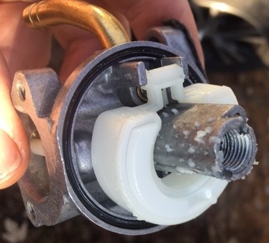

It was unused for two years; left with gas in the tank. I drained the tank, removed the carb and cleaned it clean enough to eat off it. No corrosion, just white gel deposits. High speed jet (bowl bolt) was clogged but is now open.

That white goo is from the plastic fuel tank. Briggs had a problem with them and had a certain recall on some of them because of the plastic the fuel tank was made from breaking down and causing the problem you have pictured.
That gunk clogs up the tiny passageways and jets in the carburetor plus the fuel lines and shut-off valves.
Briggs came out with new fuel tanks made from a different type of plastic and rubber parts because of the problem you just pictured. That was a couple of years ago, so check with a Briggs dealer to find out if your fuel tank is still covered by it.
