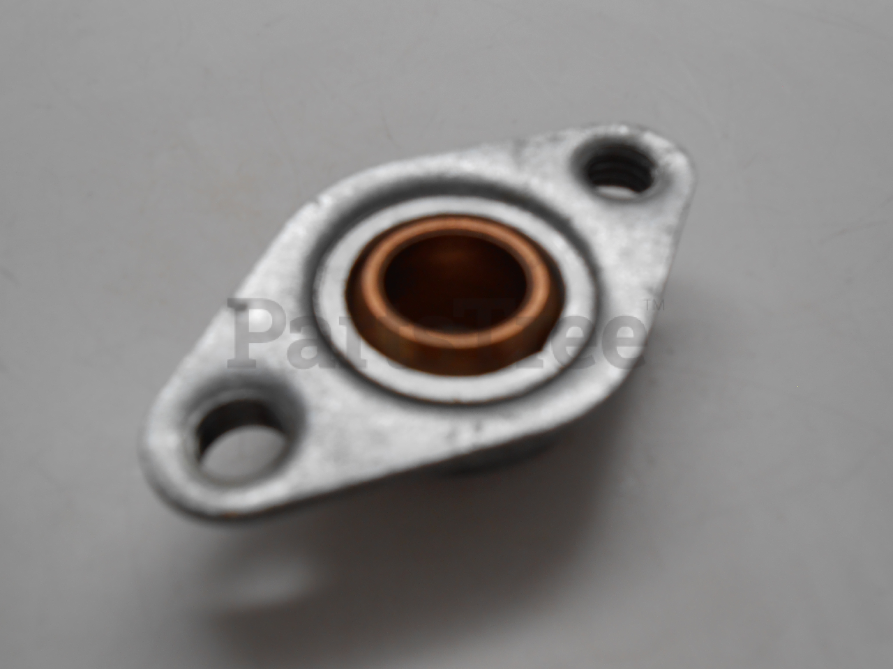

If you have a damaged/wobbly shaft in the chain maze inside the trans case. Don't only look at the shaft where the bolt goes through the sprocket, look what's hooked to that shaft via chains. I have seen more often than not machines that use these type "bearings" which I just call wobble bushings. I personally think they are a sloppy fitting for tolerance errors. If the shafts working together don't stay parallel things can get torqued wrong.
Other thing is you could just have a sharp edge either in the shaft or sprocket the bolt goes through.
