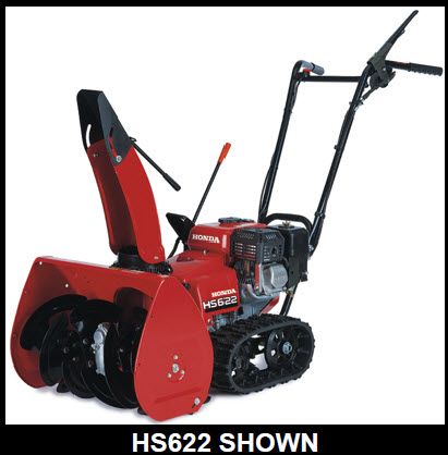

I want to change the gear oil in this model and cannot find the drain plug . This unit has a track and I don't think the gear oil has ever been changed. Any help would be thankful .

Maybe you mean an HS622?
Auger gearbox (transmission) has a capacity of 0.17 US Quarts of #90 gear oil:
Drive transmission (I think the drain plug is highlighted) has a capacity of 2.1 US quarts of SAE 5W-30 engine oil

Okay thank you Robert you have sloved my problem . I assume the filler plug for the auger gear oil is the Black colored one on the left hand side ??

It is the transmission fill that is a black rubber plug on the left. The Auger fill/drain is the same 10mm screw plug, that Robert highlighted.
