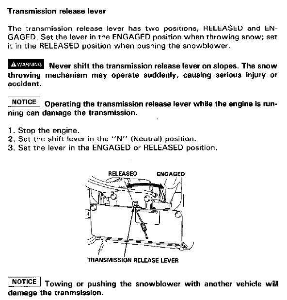

Thanks alot, I will check that overfill thing...Also have a tranny issue, that little wire you slide backn forth to engage the transmission? Nothing happens...someone told me it may be a shear pin in there? I guess I'll be finding out as I'm taking it apart tomorrow! I will post pics! And thanks for your time and help!
Go here (scroll down to the HS828 listings) and download a digital copy of the owner's manual; it has all the details on controls, service, etc.
