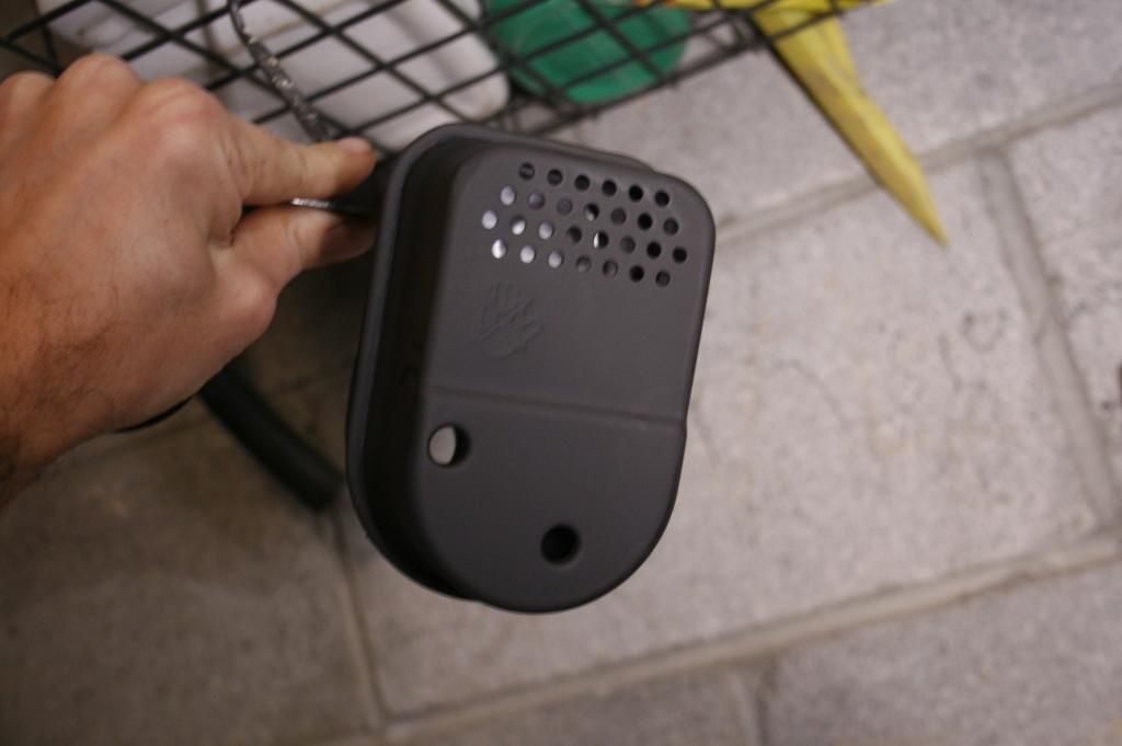

I've got a Brandy-new, shiny muffler for "Big Red's" crusty Tecumseh.
I was thinking about spray-bombing it with Rusto High-heat primer / paint. ...which is supposedly stable up to 2000 degrees!

Some great suggestions guys!
I had some Rusto high-heat already in the garage so that won-out
Now I have to wait for SWMBO to run some errands before I cure it.

That looks fantastic! Nice job. What finish was the Rusto High Heat black you used? Flat Black or Semi Gloss?
Thanks!
It just says "Black" on the can. 248903 is the item #. The cap looks semi-gloss.
Let's see if the finish changes after it gets baked (250-30m -> 30m cool -> 400F 30m -> 30m cool -> 600F).
