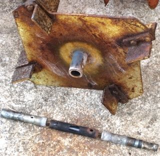

Not everything went smoothly. The impeller was rusted solid to the shaft. The bolts came out easy, but that`s as far as it went. I ended up cutting the shaft off, on each side of the impeller hub. With that done, the impeller blade lifted right out with the remaining piece of the 3/4" shaft, still in the hub.
I drilled an 11/16" hole, down through the piece of shaft in the hub, but not quite all the way through. That allowed the old shaft to collapse inward, when I set a punch in the hole and hit it with a hammer. --
The impeller and the now 3 parts of the shaft. ( I will go ahead and make a new shaft).

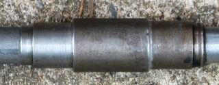

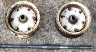

The wheels presented the same problem. Rusted solid to the 3/4" axle. I cut the axle in half. I just pulled the wheels and all, out of each side of the frame. Next, It took a 10 pound hammer, but I got the axle halves out of each wheel. I wanted to save the axle, so I took a piece of scrap round bar stock and bored a 3/4" hole through it. That gave me a 4" long tube joint, to reconnect the axle halves back together. A real close fit, with some Loc-Tite and later on some roll pins. Should still be over-kill in this case. Thought about welding it, but was afraid it might warp. I am replacing the original wheels, with these Jacobsen hubs and 2 piece split rims. (same as I did on my American Lincoln 3 stage blower).
