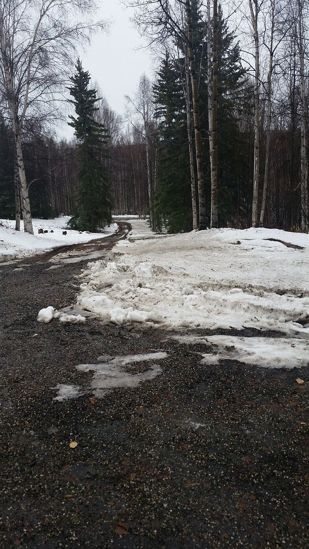

It's found many, but this one pulled it forward off the key and lost one of the set screws.
This machine used to be the Air Force's before the guy I got it off of, and that guy didn't look to do much more than put a newer engine on it because it didn't look to have much maintenance.
Unfortunately my driveway doesn't help me keep from beating it up much. Next run will have the scrapper adjusted better and I am going to look into getting someone to make bigger skids I think.
