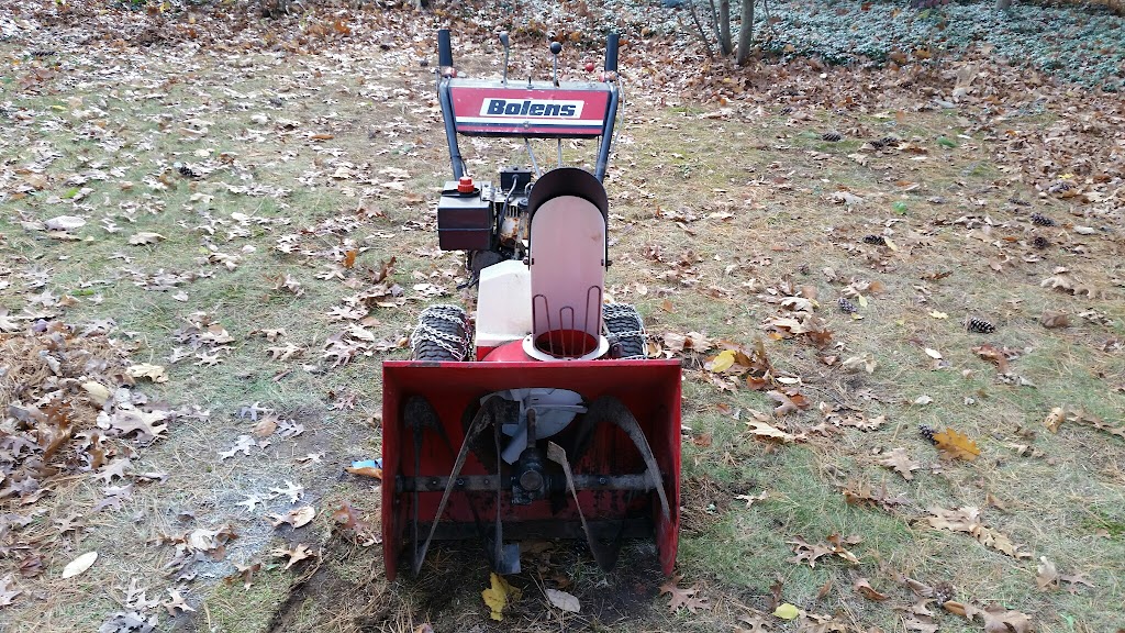

A Tale of Two Bolens
I picked up a Bolens 824B earlier this fall cheaply, and I was able to get its 8hp Tecumseh HM80 working with a rebuilt carb. Unfortunately, its frame and right handlebar were rotting to the point where I could not bring myself to use it. It was destined for the parts pile until I found a similar Bolens (824A) with a dead auger gearbox. It also had a different color scheme and the bucket shape was different as well.
As I suspected, I was able to add parts from 2 broken snowblowers to get 1 working snowblower:
Here's the 824A that I picked up today with the bad auger gearbox:
The operation is underway:
Does anyone know which is the older color scheme? As I suspected, the buckets were interchangeable. The red frame even has good axle bushings which is rare. The green frame has good tires/wheels which I'll be tranferring over to the finished unit.

The novelty of red+green look soon wore off and since the entire bucket assemblies were interchangeable, I figured that the augers+gearbox were likely the same as well.
All the parts came off easily on the red one, I was able to salvage every part.
Practically nothing came off easily on the green one, I ended up destroying the impeller pulley and the impeller bearing to remove them from the shaft.
The end result is pretty good though.

I put new tire chains and repainted the taller chute from the green bucket. I think it's ready to do some work this winter!
