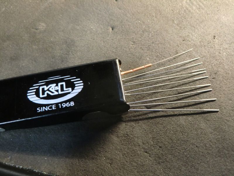

The second best kept secret of carb repair/cleaning:
Run you about $10 and will fit just about any orifice in any carb on the planet. Doesn't show too good in the picture but the wires are all spiral knurled, really gets the junk out of there.
Highly recommended.
Yanmar Ronin is online now
Post Thanks / Like - 0 Thanks, 4 Likes, 0 Dislikes
Likes bwdbrn1, Grunt, GoBlowSnow, 43128 liked this post
post #10 of 21 Old 11-28-2015, 06:40 AM
Thanks (Received): 234
Ditto on getting one of those carb cleaning tools.
Your camera will be one of your best friends too. Take pictures of the carb set up before you start taking it all apart from the engine. That way you've got the pictures to refer to when putting it back together. We've all read the posts by folks who forgot where things go when it comes time to put it all back together.
