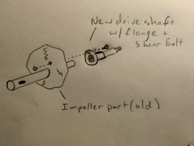

Been thinking on this too... another option if we're talking this kind of coin might be to take it to a machinists shop and explore repairs. Could be possible to cut the old shaft out, drill the impeller and replace with a new shaft, properly shear-pinned to the impeller. Or perhaps similar by cutting the pulley side of the shaft short, make a new stub shaft with a sleeve welded to the pulley side and a shear bolt on the other, or maybe to a welded on flange that shear-bolted to the impeller. No more worries after that... hmm.
Something like this:

Maybe you can grind it flat, drill a hole in the center, thread it and use a thick washer and a bolt to retain the pulley like on a Yamaha.

I think a machine shop could likely weld on and machine to size what you need or like above drill and tap the shaft for a bolt to retain that pulley.
