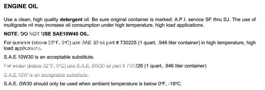

The Ariens 92200 manual shows 5w-20 but I'm also finding other sources stating 10w-30 for winter use. What should I use?
Taken from Tecumseh service manual...

But the quoted Tecumseh 10W-30 oil is a substitute for summer 30 oil. The Tecumseh quoted winter oil is 5W-30 with a couple of substitutes.

Sorry I meant 5w-30. You think I should do what Tecumseh says vs Ariens?

Don't stress about overthinking this. I've used 5w-30 for many years without a problem. The Tecumseh advice was likely written many years ago, perhaps before 5-30 was common. For me, synthetic is worth a couple of bucks more.
Yes.
