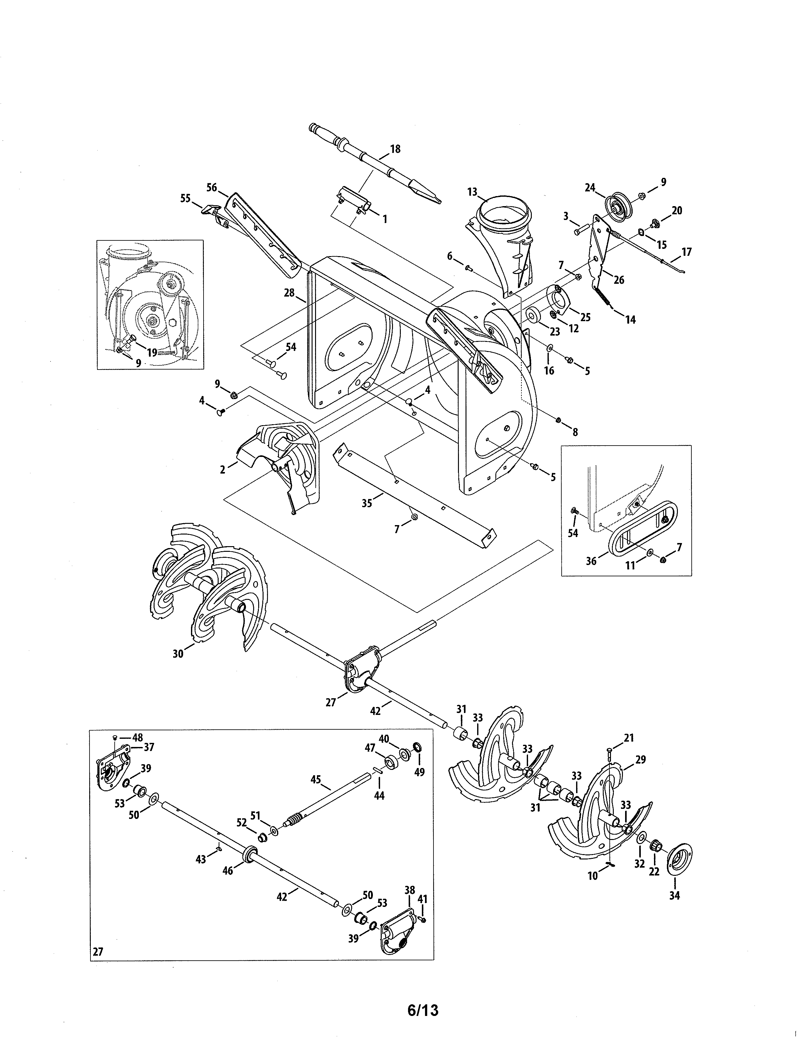

I have a 2015 Craftsman 28" Snowblower (Model #: 247.883951) with a broken auger axle. Is it possible to replace this part without opening the gearbox assembly? In other words can the auger axle be slipped free from the worm gear without taking the gearbox apart?
Any help would be much appreciated

No. There is a key (#43) that holds the gear and it's not going to come out of either side unless you open up the gear case and pry the key out.
