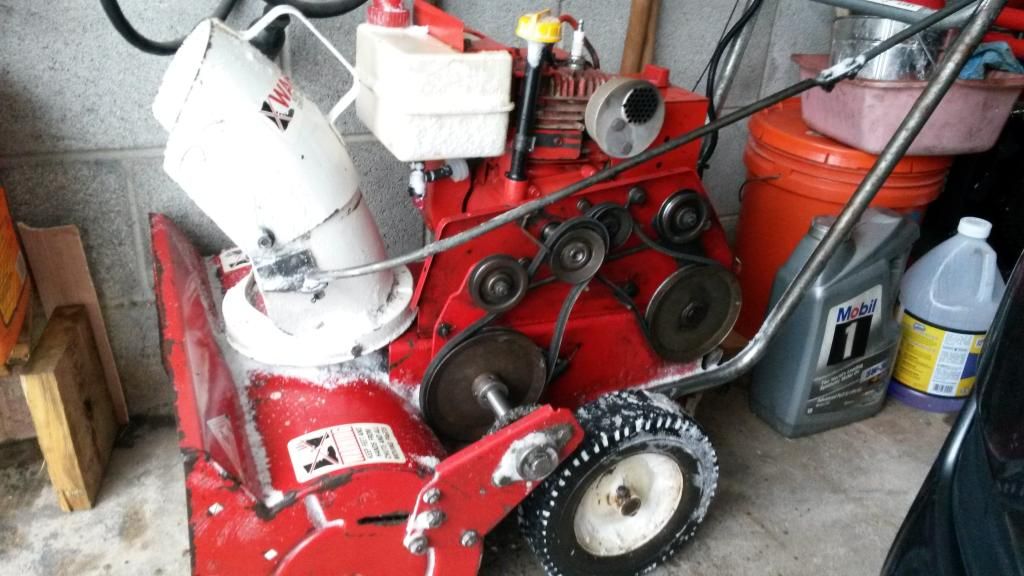

Is this the machine you're referring to?
If so, leveraging auger speed & torque is the name of the game for this...I had to play around with gear ratios to get it throwing with some authority.

That is the Rube Goldberg show blower!!!
'77 Ariens 924032 "Brick House" Re-Powered with a TEC 10HP and oversize auger pulley
