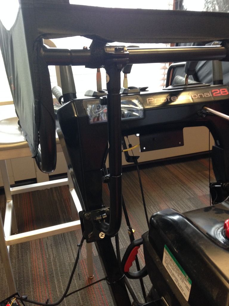

Here is my review of the machine on youtube.
Also, I did contact Ariens company about the snow cab on how it fits on this machine. They explained how it fits. I didn't care for their method as the bars seem to block the headlights I put and the cab (to me) sits closer to the engine. It also seems a tad to short compared to my other machine which the cab is mounted.
Here are their pictures that they sent me on how to mount the snow cab.
Ariens hydro pro is online now
