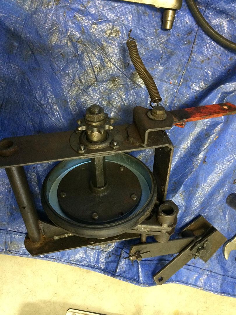

"Putting a friction disc on is child's play. the inside of a friction drive machine is gravy simple. the best advice I can give is, TAKE IT APART and look at it closely."
That's not always true as they aren't all built the same. Most are really simple but some you have to pull out almost everything to get the assembly the friction disc is mounted in, out.
Look at it closely first, take plenty of photos from different angles and THEN take it apart.
Best chance of getting it back together properly.
Just ask WestminsterFJR
