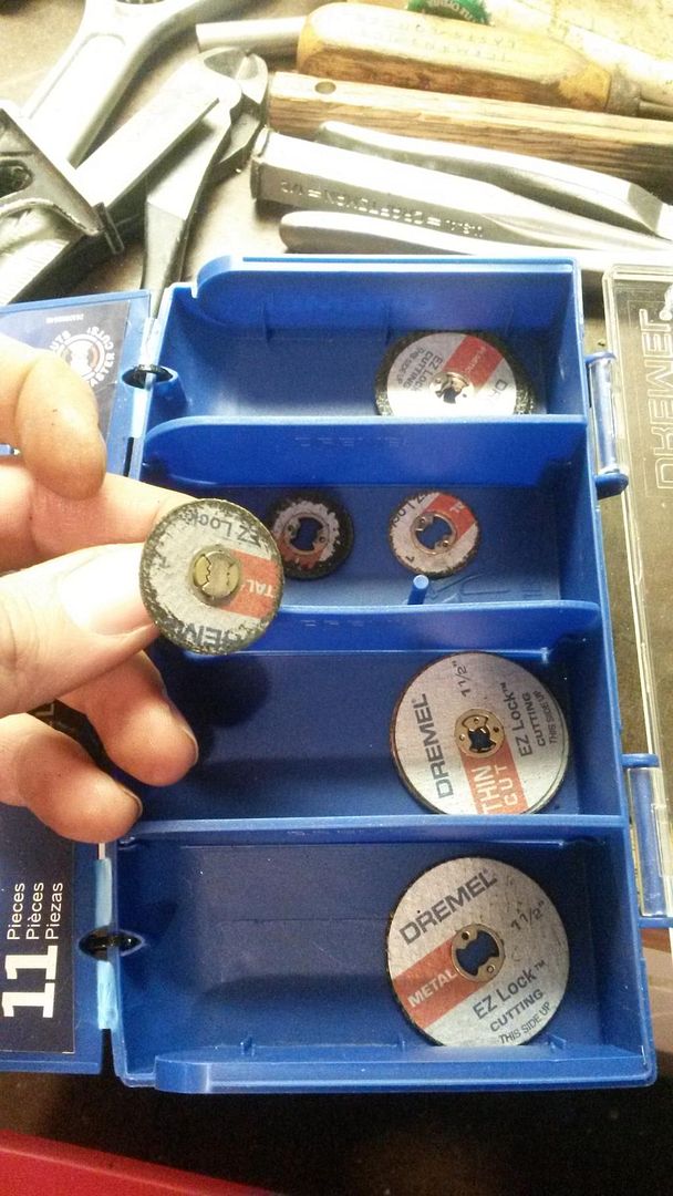

I use a makita grinder for coarse work...
when I want to get surgical, this dremel metal cutting kit is the mutt's nuts.
I used these to remove all of the welds on my Toro824.
