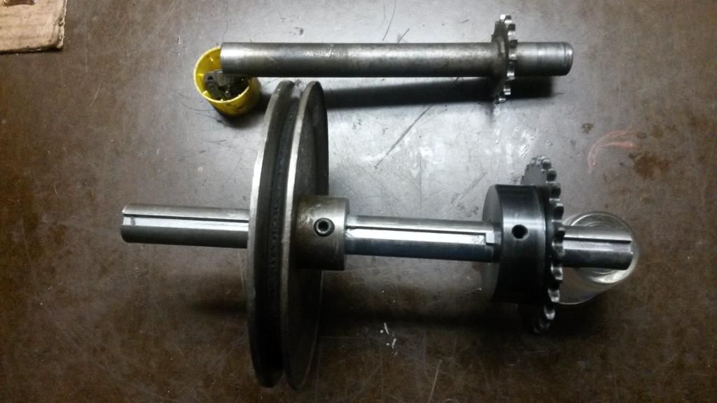

I had to do something similar in my '72 Sears (signature).
top: original drive-shaft/sprocket
bottom: swapped the belt pulley and added a larger drive sprocket
Note, the shaft rides in a bearing. I don't think that keyway would be kind to a bushing.

Wow, that's a great looking piece. Turns out I can't do that because the stationary sprocket/bearing assembly shaft is part of the transmission mount system. I'll just keep looking, after all, winter is over, right?
