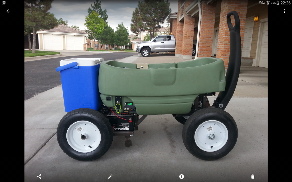

Here is the wagon. Step 2 wagon, 24v mobility scooter motor and transaxle, two Duracell AGM batteries, wheelbarrow tires and wheels, tube frame, cooler, 12v 180# actuator with PWM for steering, Spectrum 3-channel receiver and transmitter, Castle Mamba Monster 2 ESC, 12v inverter for 120vac and USB.

Is this running from one motor or two?
post #10 of 13 Old 02-06-2016, 01:40 AM Thread Starter
Join Date: Feb 2016
Location: Denver, CO
Posts: 10
One motor with transaxle (allows inside wheel to slow down in a turn) and front wheels (will be skis) turning like traditional car steering.
