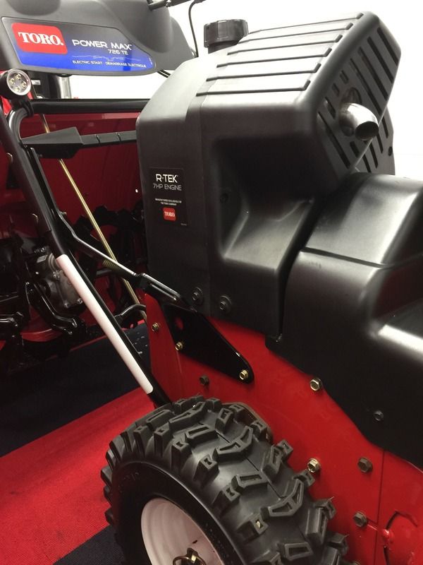

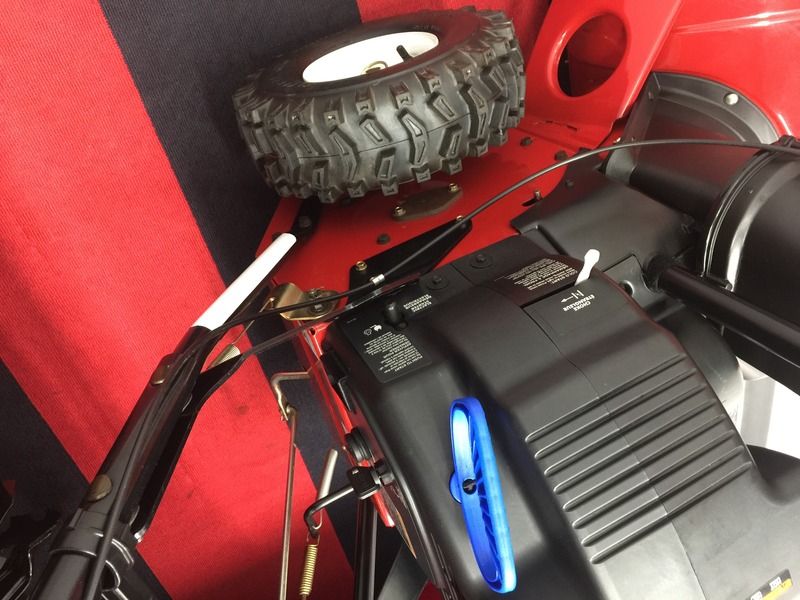

Hey guys - wanted to share a nice little add you can do to your PowerMax. I added the weight kit to my 726te and noticed that the extra weight made the handlebars seem very flexible, to the point the machine didn't feel very solid. Looking at the commercial 1028 model, I noticed that it had "wings" that tied the handlebar to the chassis. I found the part number for them and ordered them and they are a direct bolt-on for my 2005 model powermax, so I assume they would be for all years in between. They add substantial bracing to the unit, and make the handlebars feel extremely solid and strong with absolutely no flex, even with the weight kit on the front.
I highly recommend these if you want to stiffen up and strengthen your PowerMax - even without the weight kit these should make the machine even more robust and responsive.

An easy, simple, direct bolt-on high impact mod. I'd honestly recommend it if you have any model of Toro PowerMax.
