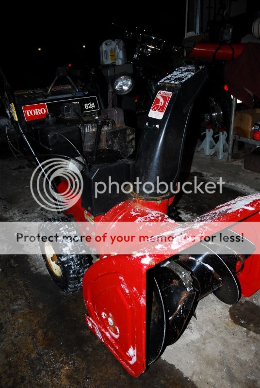

Well I picked up my new to me 8-24 Powershift tonight, never thought I would get excited over a snow thrower! It's a little rough and needs some TLC but I got what I wanted. I was told it was around 10 years old, turns out it's a 1988. Overall it's in decent shape, the engine has rust on the shrouds, needs some carb work (loads up when running into packed snow), and the headlight doesn't work. It also has a problem with the power shift, it worked in one direction but not the other, just some gear griding noises. It's 2 degrees outside now so it'll have to wait until I get some time and the weather breaks to figure it out. The real plus is that it has electric start, the previous owner didn't think it did. It came from a landscaper so it probably has some hours on it but with the condition it seems to be in, I might be wrong. He did say they hated to use it because it was so heavy, that was the reason I wanted it!
I had to try it out and was pretty impressed, still have to learn how to use a 2 stage instead of my single stage. I've just downloaded the manuals from Toro, will spend some time reading up on things, I'm hoping the powerhsft problem is something simple, but if not that's OK, for what I paid for it, some new parts are to be expected.
