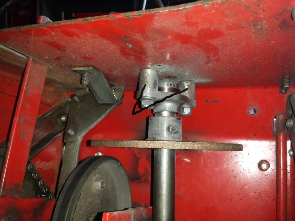

Only the one at the back is wearing out. I believe it is the 2 standoffs are not equal in size and thus the bearing does not sit straight. The standoffs are no longer available. I could probably come up with new standoffs but was thinking that a self aligning bearing would solve the problem. The added bonus would be the cost is about a third of the Toro bearings.

post some pic's so I can see what is going on..

Sorry for the slow response as I was away fishing. The following picture shows the 2 standoffs for the bearing that keeps wearing out. You can see all the metal filings from the worn bearing. The bearing on the front of the shaft is new and has no wear after 1 season of use. The back bearing was replaced at the same time.
I was asking about changing this to a self-aligning bearing to correct any mis-alignment.

Any chance the tension on the drive clutch is way too tight causing excessive bearing wear?
