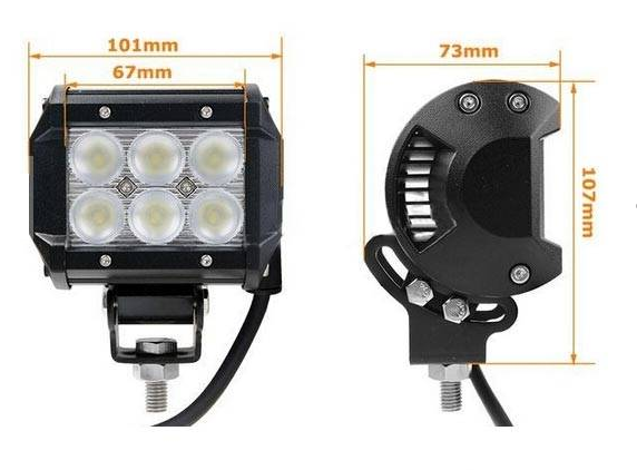

Before trying to replace the #892 with an LED replacement such as HID White 10W 880 889 892 890 Samsung 2323 LED FOG Bulbs Light 6000K 12V DC | eBay for example, I would suggest you measure the DC voltage with a multimeter, then measure the AC voltage riding on the DC. If The AC riding on top of the DC is more than 2 volts peak to peak or close to a volt rms you might see flickering depending on engine RPM. It can be annoying. Not really room to add big filter capacitors so you might want to change the whole light housing at this point. Lots of them for sale on line of different quality.
I kinda like this one, it says water proof and looks ruggedly built. Only thing it doesn't mention cord lenght.
4 Inch 18W Cree LED Work Light Bar Lamp for Car Truck Off Road Sale-Banggood.com

I'm just about to revisit this issue. So I'm breathing new life into the thread...unless of course someone already solved it...I like the suggestion by coby 7. I suppose I could use a rectifier of some sort if there is flicker.
I'll let you know what I decide.

It just so happens I have one of those waiting to go on my PowerShift !!
Waiting on the slow boat from China to bring the rectifier and caps for the install.
It's about 14"
