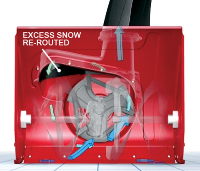

Still trying to figure out why the Auger part is a large drum. the newer ones seem like it's just the blades rotating.

The Toro drum design was their first anti-clogging system. No matter how fast you plow through the snow, the drum will only let so much into the impeller preventing it from clogging. The snow that doesn't make it into the impeller will just be thrown forward and scooped up again. It's actually a really good design, but that 826 won't have problems going through some really deep snow. I used to have one, and kick myself for selling it.

My Powershift has the "drum" auger too. The new anti clog system uses a plastic housing to redirect the excess snow back to the auger as Threeputtpar mentioned.
