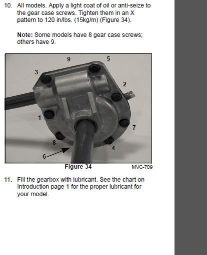

that's where I'd start. My '89 service manual says that they should be torqued to 120in-lbs.
here's the tightening sequence:

Thanks for the suggestion and pic!
Last time I had a similar issue was on my parents' 1997 Nissan Pathfinder. The valve cover bolts rattled themselves so loose that the truck would be pissing engine oil on the exhaust and burning it... it looked like the engine was on fire, lol!
Tightening the bolts fixed the problem on the Nissan. Hopefully, the Toro will be the same (I love cheap fixes, lol!).
Question: how do you tighten the bolts in the back of the gearbox case? Do you need to take off the auger? (I'm not near the machine right now, but I believe access is very restricted back there from what I remember)
