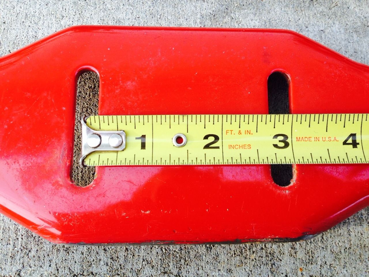

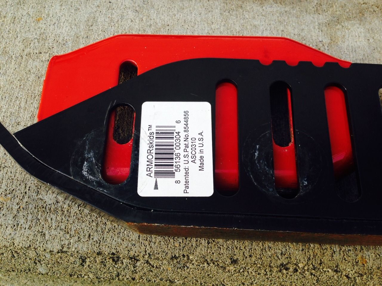

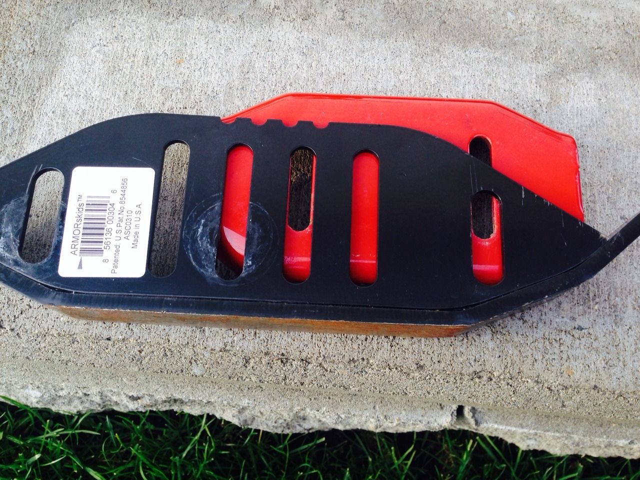

I took some pictures for you.
Bob is very good to deal with , he read in the Toro Forum that I took my Armour skids off as it it would ride up on the snow that came off my garage roof . He contacted me and sent me free of charge a new design of skids. Hope this helps you Degreaser.
On the last picture you can see which holes I mounted it on. I used washers for spacers

Thanks Hanky for the pictures, that one picture of your Toro stock skid with the measure tape does confirm again what my Toro dealer told me on the phone this morning, he measured skid center of bolt to center of bolt on the Toro PowerMax 826 OE floor model and it's 2 7/8" and said the 826 OXE would be the same
