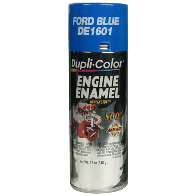

A bit of research suggests "Ford Blue DE1601" is a close match to OE color, even if its slightly off it wouldnt matter as the whole blower is getting painted.
Duplicolor sells it in cans as well

That's the color I used to paint my dolly. But I believe Beauty Tone is closer.

^^ Thanks, unfortunately that brand isnt available here in the US.
