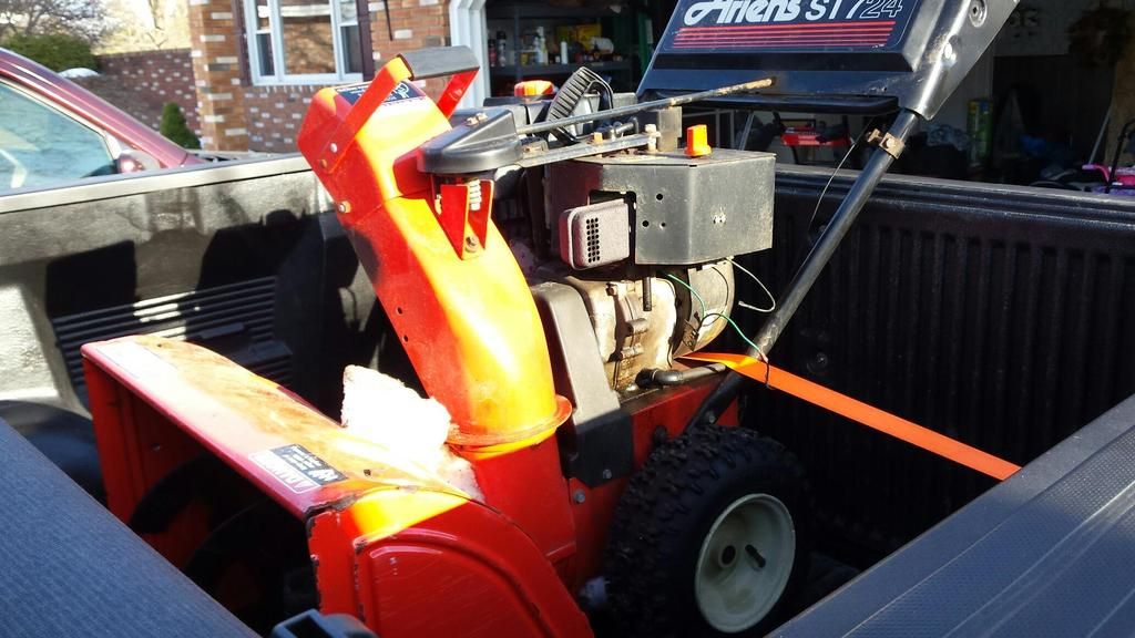

A friend from work stopped by my office asking if I’d be interested in his father-in-law’s Ariens snowblower that crapped out during the last storm.
It already had a one-way ticket to the scrap yard!
The decision was easy … aided by the fact that my wife is out of town for a few days on business :icon_whistling:
It’s a 1995 Ariens ST724.
He grabbed the machine last night and we transferred it to my truck over lunch this afternoon.

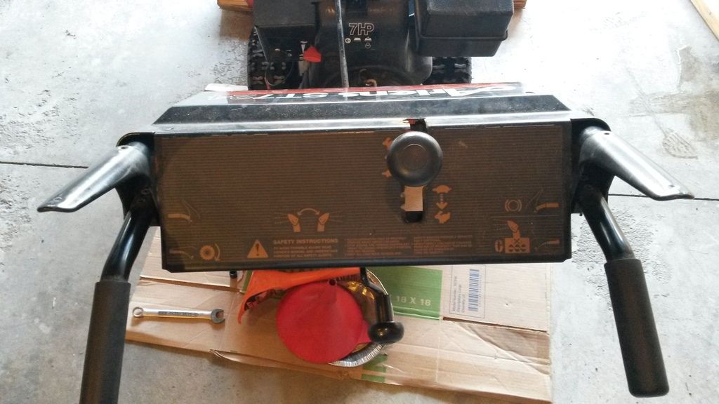

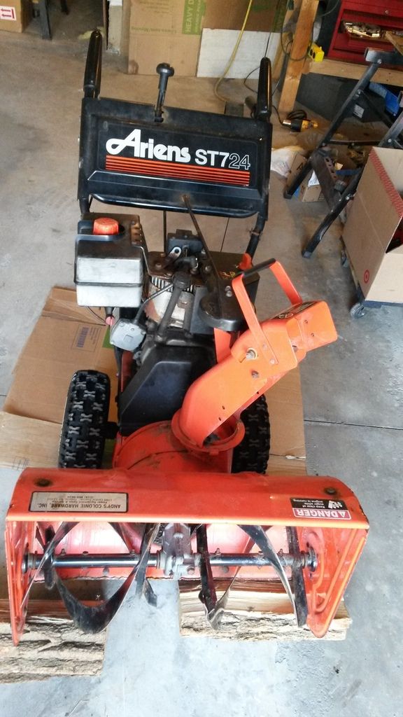

1st Impressions.
The Good:
  • It’s tiny…and light!
  • Tractor/auger are 7/10…just need some touch-ups.
  • Handle-bar/controls are intuitive 6/10 …surface rust and missing bolts.
  • This might be a keeper for the Mrs!

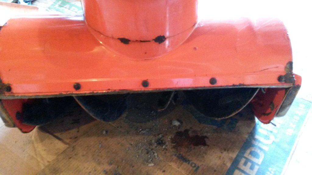

The Bad:
  • Plastic wheel rims. The wheels are very wobbly.
  • PO has a weight mounted on the underside of the auger housing...that weight didn't do those whimpy plastic wheels any favors.
  • Skids are hosed & the scraper was taken literally right to the edge of the auger housing.
  • Shots of the obligatory belly-pan mouse house...yum!
Ariens gurus...please tell me that these can be replaced with steel rims!

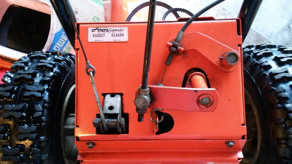

traction assembly looks good... plastic drive gear??
^^ if I had to repower with a single output shaft, it looks fairly simple to reverse the direction (cams spin backwards). The main obstacle is speed. The Cam spins 1/2 of the crank speed. There's not enough room in this tiny chassis to fit a much larger traction pulley.
