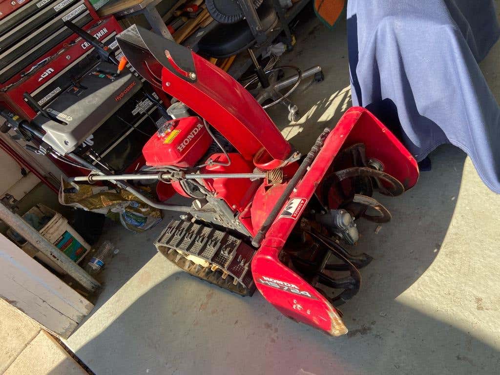

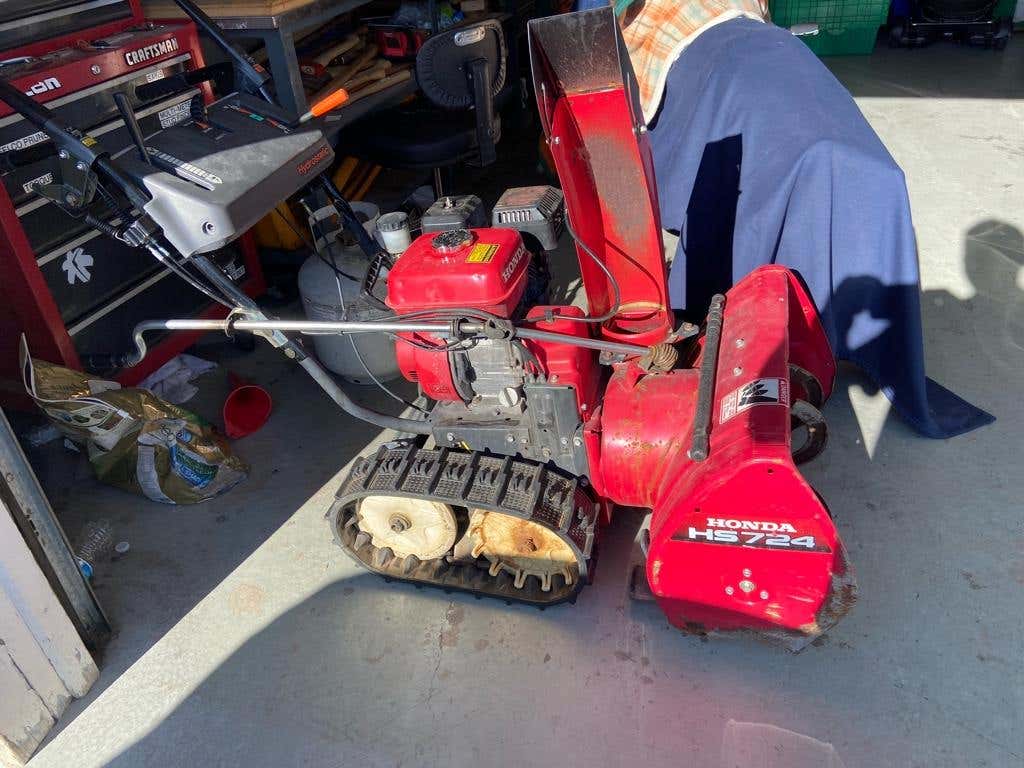

So I just grabbed this tired HS724 today on the way home from work for a whopping $50 dollar bill.
The auger is totally shot, the hydrostatic drive won’t engage, but it starts up and runs with fuel gushing out of the carb. Lol (clean one owner)

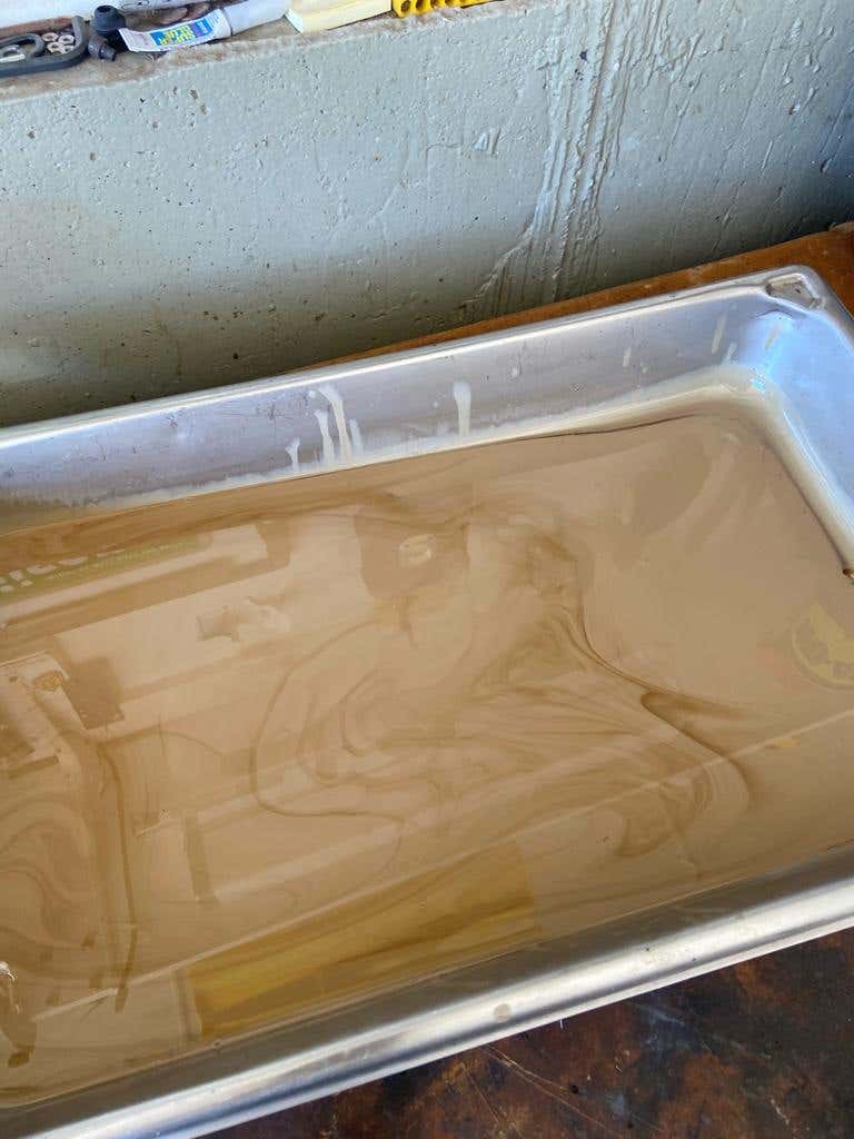

The oil is like thick chocolate milk, Bad sign, and there is a bad tick-tick-tick that goes away after a minute or two .
Why is the oil like this on an air cooled engine?

what does the oil smell like? gas? maybe water in oil.
$50 is a steal even if this turns out to be a parts machine. parts are probably worth $500-1000 on this machine even sold at half the new Honda price is what I do.
how is the hydrostatic oil level? if low, check seals on tranny on the drive axle. if a seal is pushed out , maybe oil leaked out there. they push out if cover of reservoir is on too tight and can not breathe. you can push seal back in and there is a bleeding procedure you can do without removing tranny.
Honda states you have to remove the tranny but I have done an inframe bleeding at least 7 times and it has been successful every time. not sure if that is the problem. 2nd thing to check. 1st thing is make sure the tranny lever is in the engaged position. to the right. 3rd thing to check is the drive pins on both drive wheels are present. these are easy fixes. other than that then an internal failure which is EXTREMELY rare on these HS hydro-static transmissions.

if the float is not working right the carb will overflow if gas valve is left on and drip into crankcase. see this a lot with machines that are left sitting for long periods.
usually just needs a good carb cleaning. change the oil out a couple times.

if the carb is leaking it will fill up the intake which will usually work its way into the cylinder and then into the crankcase. you may definitely want to see about getting the carb cleaned out and that leak fixed first. you will likely need to do another oil change after you get the carb to stop leaking just to get the all the gas out of the crankcase. had a similar issue happen to my brother in laws snowblower and had to do 2 oil changes to get most of the gas out of the crank case but it will usually stop smoking after the first oil change.

Carb rebuild or New; chocolate milk oil means water in it, when this happens to me I do a flush with kerosene, do not use gasoline as I've read do not do it because there is a chance of an internal explosion which means a grenade with fragments and death.
