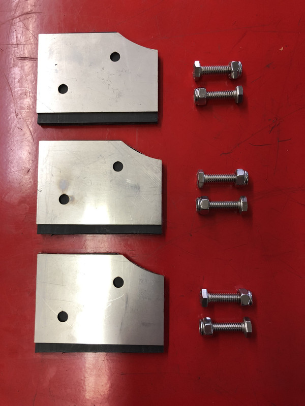

Hey all.
I’ve been dabbling with the idea of building some HSS impeller seal kits and decided to pull the trigger.
-For the purpose to Maximize potential and further improve performance.
-Eliminate clogging & throw further.
*Premium stainless steel reinforcement plate.
*Premium stainless steel hardware.
*Premium 3 ply belted rubber
- Additional benifit - protects impeller housing from damage from rocks can can potential jam between the impeller and housing causing gouging.
The HSS impeller is a new larger diameter design. The shape of the blade and location of the reinforcement underneath makes for a difficult install. Universal impeller kits Do NOT fit.
I put together a kit that lines right up with the shape of the blade resulting in a clean look and easy installation.
*Simply adjust the belted rubber seal to the housing.
*Lay the plate down lined up with the contours of the impeller blade.
*Clamp into place then drill through the pre established holes and bolt into place.
My kit fits ALL HSS724 HSS928 and HSS1332 machines.
Please follow the link to view.
https://www.ebay.com/itm/333092216923
PM me with any questions. :blowerhug::blowerhug:

DO you have a backing plate to support the rubber paddle or are you using the impeller paddle as the backing plate?
Clarence always had his pieces of conveyor belt pre drilled and long enough that they were tight and scraped the interior of the housing clean and wore down over time.
Have you cut away the steel sheet metal that is tilted inward on the chute used to concentrate the flow of snow being blown out which causes the clogging issues on your type of machine?
I would still use plenty of fluid film to blow the snow across the road with the rubber impeller paddles as a matter of doing the job easier.

The rubber is bolted on to the impeller blade with no need for a backing plate.
The rubber seal is not pre drilled. It is sized to fit up against the impeller housing.
I have not removed the chute collar. I did modify its size and pitch.
Fluid film or any other spray lubricant does not work for any significant period of time in the housing and chute.
