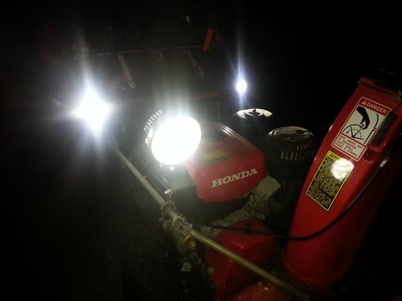

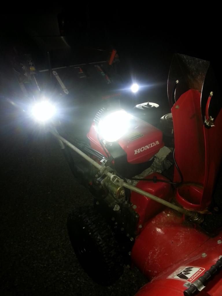

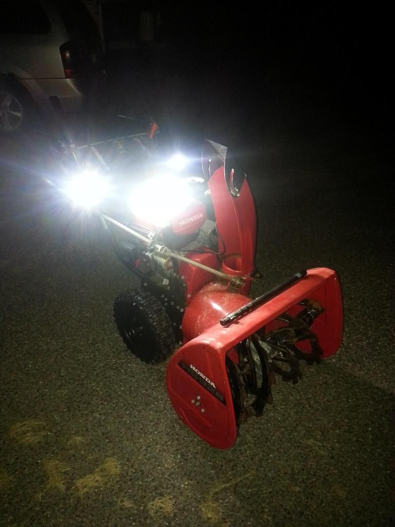

#246 · (Edited)
Allright, so I finally finished up the LED install on the Honda. I figured I should stop procrastinating because once the baby is here (11 days past due right now) there isn't going to be much extra time on hand to get this project finished up! So here are some non snowy pics of the three LED install, video will be forthcoming once it snows a touch to get a real feel for the brightness of the LED's
#261 ·
That looks fantastic! Needless to say...I think I know what I'm doing :)

#258 ·
[/ATTACH][/ATTACH][/ATTACH][/ATTACH][/ATTACH][/ATTACH][/ATTACH][/ATTACH]
This is my honda snowblower. And thanks to your guide i was able to mount my 10w led flood with a bridge rectifier and 2 two 2200mfd 50v capacitors. No flicker!
Thanks guys!
Only some of your pics attached, but from what I see it looks awesome! You and I had some of the same ideas for mounting the LED's.
