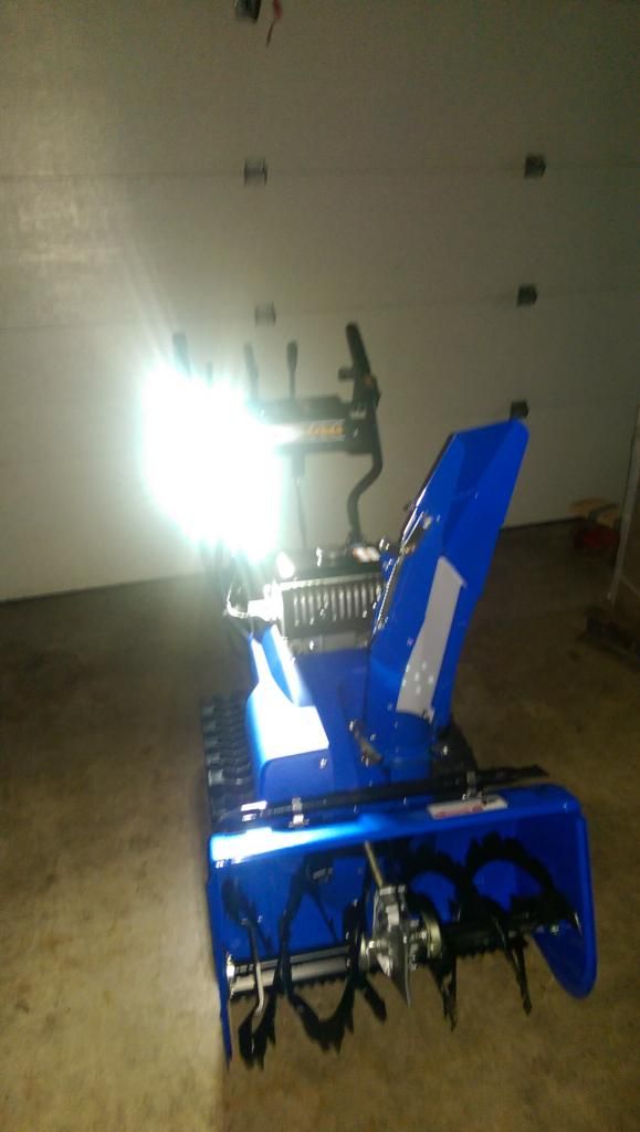

Here's a pic of how I installed my bridge rectifier, I mounted it right next to my keyed switch that is on my handlebar console. I also used heat sink paste to couple the bridge rectifier’s metal casing to the console’s metal. I know this is way overkill, but my bridge rectifier came with the paste, and it was an easy application of some paste. The bridge rectifier I used is rated at 50amps 100volts KBPC5010 Bridge Rectifier | Alltronics

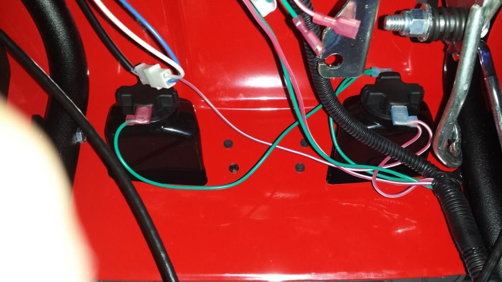

Where the two wires come out of the harness for the lights under the dash they go right into the one light almost immediately. I was going to cut that off as my AC source for the rectifier and then run the DC leads back to that first light that then parallels over to the second. Where they come out of the harness they are not even long enough to get terminals crimped on so that is why I was going to extend them and then run it to wherever I mount the rectifier so I can tuck it up under the dash, out of harms way. Does that make sense? I haven't really looked at it to hard and I need to look at it again before I actually start to mess with it. I forget where exactly all the wires went when they came out of the harness under the dash.
#281 ·

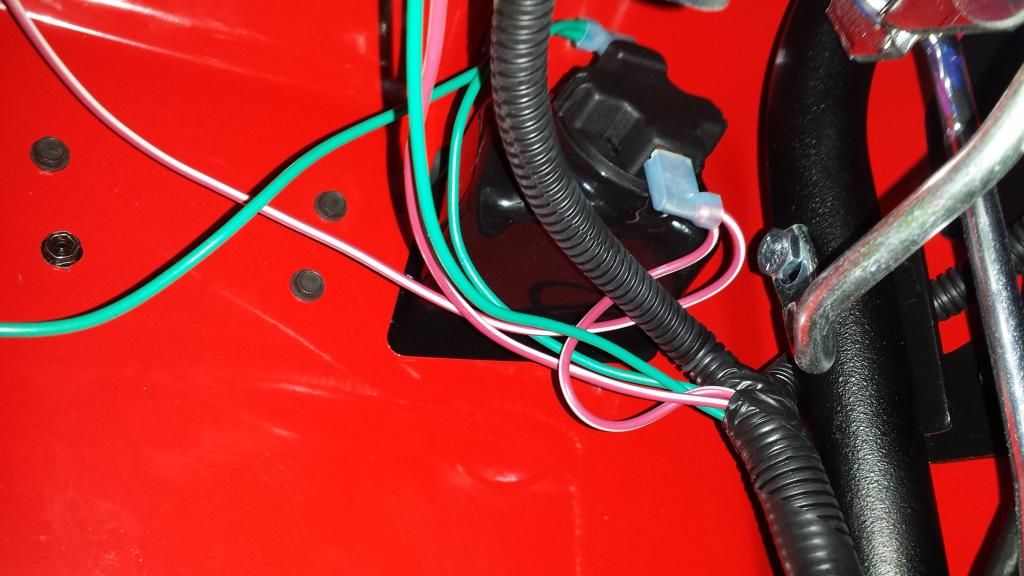

Here is what I was trying to explain. The red wire going to the lights is the AC power and the green wire goes to a ground on the motor if I traced it right. Plan was to cut into them and mount the rectifier in between the two lights. Also I am still not 100% sure how you splice the caps in. I was looking at this at work and pictures don't show up, are there any pictures in this thread of the wiring of the caps? I know what they look like and how they work just want to make sure I do the best job I can once the rectifier arrives.

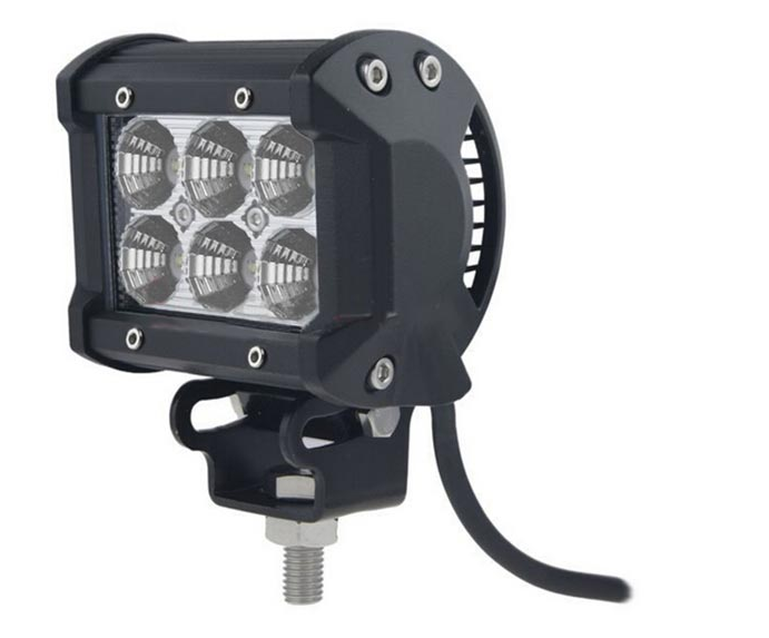

Are any of the Cree 10w spot/work lights like this photo built with components to reduce flicker?
#286 ·
The cree light you posted does not come with any rectification, very few floodlights that I have found do.

Operating Voltage: 10-30V DC
Waterproof rate: IP 67
Beam Pattern: Flood beam,Spot beam
Color Temperature: 6000K (pure white)
Material: Diecast aluminum housing
Lens material: PMMA lens
Mounting Bracket: Stainless Steel
Theoretical Lumens Output: 1400 LM
LED Power: 18W (6pcs*3w CREE high intensity LEDs )
