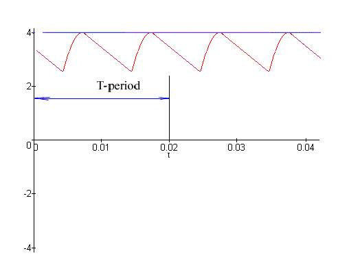

Heated grips would not need DC and they may do this to reduce the amount of AC on the line. You already know Capacitors will filter A/C but what you may not know is that inductance will also filter A/C and at these currents maybe more efficiently. Heating coils have a certain resistance and for a reason, resistance causes heat, but it can't do this without inductance and inductance filters A/C. What I'm saying is they probably do this on purpose to remove flicker on the DC output. It's a theory nothing more on my side.
Here is what the output expected voltage would look like if they would use the heated handles to filter the voltage
Better DC and less A/C riding on DC

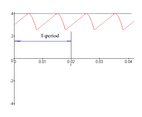

#318 ·
If it helps this is what the wave would look like if you added a huge capacitor. Basically the same as turning on handlebar heaters but reversed.
