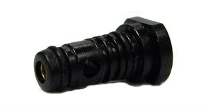

Adjustable needle main jet installed. The stock main jet is #82 for my 301cc 8HP Predator engine. The replacement jet has had its number stamp sanded/ground off. Most likely, it has been drilled out to a larger diameter allowing the needle to do the metering.
On my machine, I currently have the needle opened 1.25 turns out/open when loaded with the auger/impeller spinning. However, until I get a good dumping of snow to load the engine fully, this is just a starting point.
Chris, I noticed the external arrangement of the needle valve setup. Starting from the bottom, it's the hex screw/needle body, spring, washer, and o-ring. There's not much tension provided by the spring. Maybe preload the spring with a stack of 3 or 4 washers to increase?

Yours looks identical to the one I have.
How exactly is an O-ring with almost no pressure on it supposed to seal against the threads on a screw?
Because if you look, that's exactly what they did.
The one on the Tecumseh carb I have seals against a nice smooth shoulder.
Some dude in his basement puttin' together kits from readily available off-the-shelf components.
