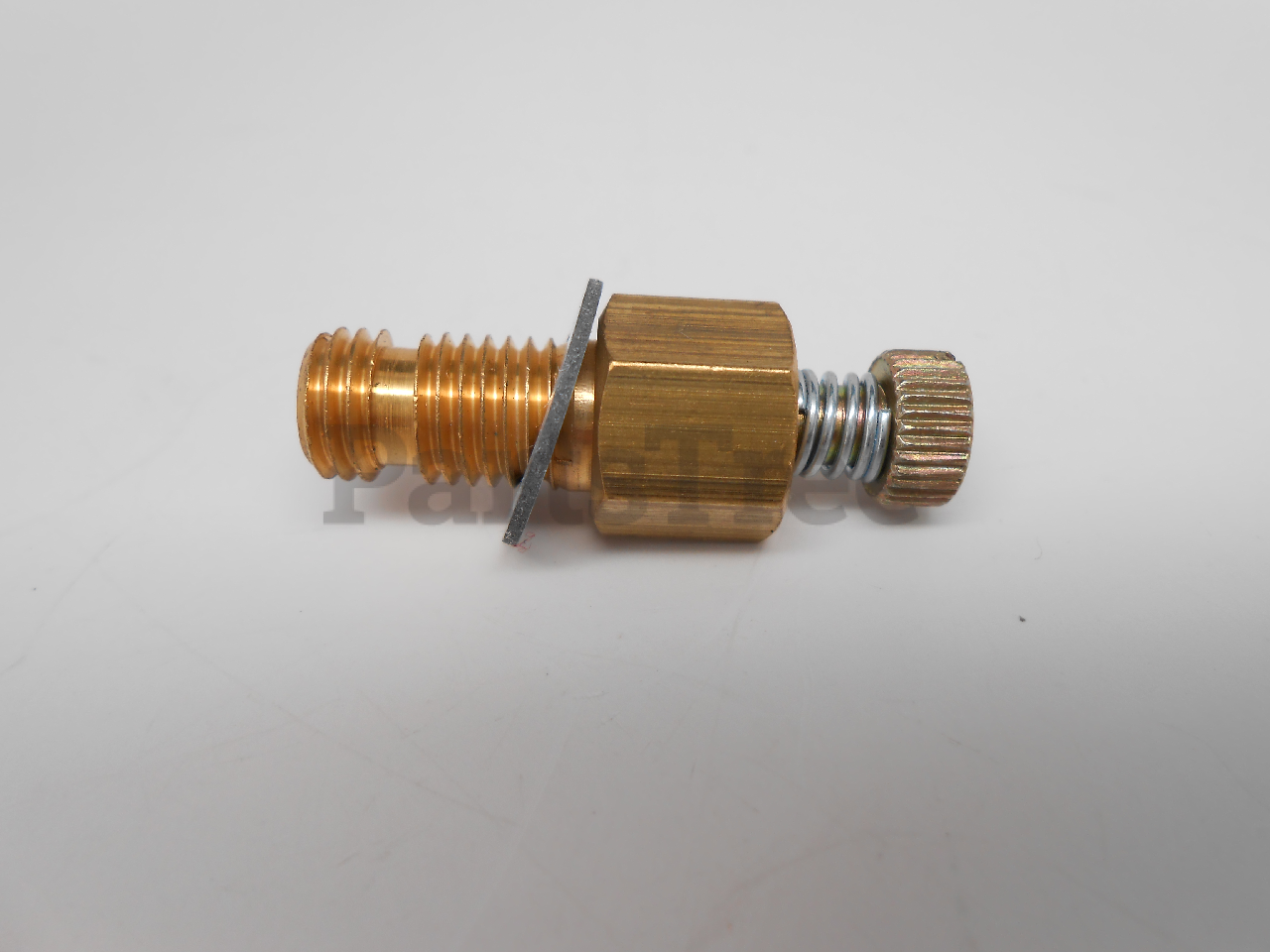

I have removed the entire main jet from the bowl. I do not have a hole in mine like the one in your picture. I have removed the idle jet and cleaned inside. I have also removed the bowl and the main jet. I sprayed up into it to clean it. It will run pretty good for 30 min. then I need to do it again. I am going to clean out the tank and replace the fuel line incase I am getting debre. I am going to get another carb and rebuilt this one incase the rebuild doesn't work

And yes the hole can be real small, clean it up good, blow it out with air if you have a compressor.
I think ( not sure) that they all should have a hole?
Maybe someone can verify this?

As mentioned, the transfer hole is very small.
No hole in jet component. Pics included.

Never seen a Tec of this vintage that didn't have the hole (nor does the Tec manuals show any), and this issue is common on older machines, since any gunk in the float bowl hits that piece first . . . fine black grit from old decaying fuel line is notorious for this, and I have had to reclean a couple of times even with new line to get it all out of the system. If you do have a decaying line, the new carb will clog in exactly the same way, with the same results . . . new carbs are frequently a source of new problems and not solutions.

The holes are behind the side Welch plug and goes in to the throat venturi.
