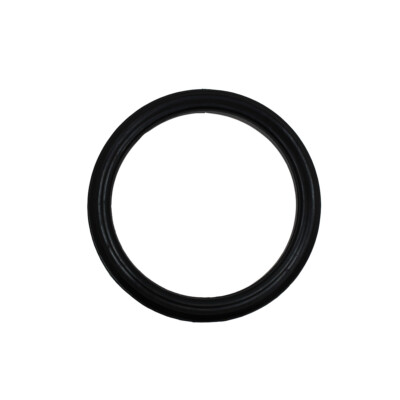

So last year I was fixing up this old MTD machine. Its drive wring was worn almost completely away. No biggie, they're easy to replace. So I replaced it with a brand new one. Then packed the machine away for the Summer. This Winter, we've had four smallish snow storms. I fired the machine up and used it to clear my driveway. Its not that big of a driveway, I live in the suburbs, not out in the middle of nowhere.
So here are the results, pure madness:
The original worn out drive ring that needed to be replaced ^
The new replacement drive ring installed and looking ready to go ^
The new drive ring after four small snow storms, about 4 total hours of use! ^
What the hell??? How does this even happen? These drive rings are supposed to last YEARS. This one failed spectacularly after just a few hours. Yes, it also gouged the hell out of the friction disc. Those strips are, I assume, the rubber. It didn't wear out, it just peeled away into these strips.
Has anyone seen this happen? This seems like complete madness to me!
Also if you noticed, the first two pics are youtube screen captures. I actually made a video about the repair process. MEANING I have a very detailed history of exactly what I did and how I did it. Although I can't think of any possible way to mess up, that would cause this??
I don't even know what to do. I mean I can replace the rubber again, but will it just look like this again after just a couple of hours of use?

and in your vid.. around 3min20sec mark.. we get a 'clear'ish view of your alloy friction disc.. it aint pretty then.. this doesnt help either..

I'm no friction drive specialist, but... could the ring have been slipping on the wheel causing it to heat up/expand/disintegrate?

Check the trueness/rotation of that hex shaft that friction wheel assembly is connected to. Just turn the drive wheels by hand and see if it runs true and not wobbling in an eccentric motion. Have seen those bushings / bearings holding the hex shaft get worn and cause friction drive wheels get eaten / torn up like that. Please post up your findings....

Possible the friction plate axle / shaft is bent or bad bearing causing plate to spin eccentric. Carefully look under the machine with engine running and see how the friction plate is running. Also... bearing assembly that holds the friction wheel could be worn or deflect under drive conditions and cause your problem. Hope we can get you sorted out and get this machine fixed.
#20 ·
Incorrect.... in your video that I just watched... you never spun the friction PLATE.. It turns all the time while engine is running. You can't turn plate by hand easily because it has a spring tensioner on the belt closest to the engine. Possibly it's not running true. Thinking a bit on this problem, how much tension are you applying to the friction wheel plate engagement itself ?? I usually adjust to 1/2 the distance of travel on drive lever bringing friction wheel plate to the wheel making contact, then the rest of travel is movement of the spring. Hopefully I've said it correctly, sometimes it's hard to explain in words when showing what I'm talking about in person. I'd like to get this resolved and get your machine working correctly. Seems like you are mechanically inclined after watching the video. We must be missing something, hard to fix without hands on and see in-person. Where you located??

Adding my 2 cents ... he said he only runs it in 1st gear ... having it too close to center will destroy the rubber as well.
To destroy it like that could only be a couple reasons im my opinion ....* operating it too close to center * continually shifting on the fly * too much pressure on the disc to plate (or too little) * bad bearings/carrier causing intensive walk .. * or not the right rubber insert, or installed incorrectly
I suppose it could have been a manufacture defect in the rubber composition ?
Shouldn't there be a drive plate return spring on the other side?
Also, on another note, shouldn't the brake for the auger also have a return spring?

At about the 10:42 mark in your video, the hex shaft that the rubber friction disc is installed on seems to have excessive slop, both vertically and horizontally.
It almost seems like the nut on the left side shaft was not fully seated when reassembled.
What condition were the hex shaft bearings?

After all this discussion I see the forces involved that are probably doing the damage. Using the lowest speed has the tire closest to the discs center. As it moves away from center the sideways pull on the tire reduces. That stress exacerbated by the longitudinal free play of the hex shaft may be the culprit. That stress surely heats the rubber making failure more likely. I wonder if any builder of friction drives ever did lab testing to evaluate friction tire temperature relative to running position. :unsure:
