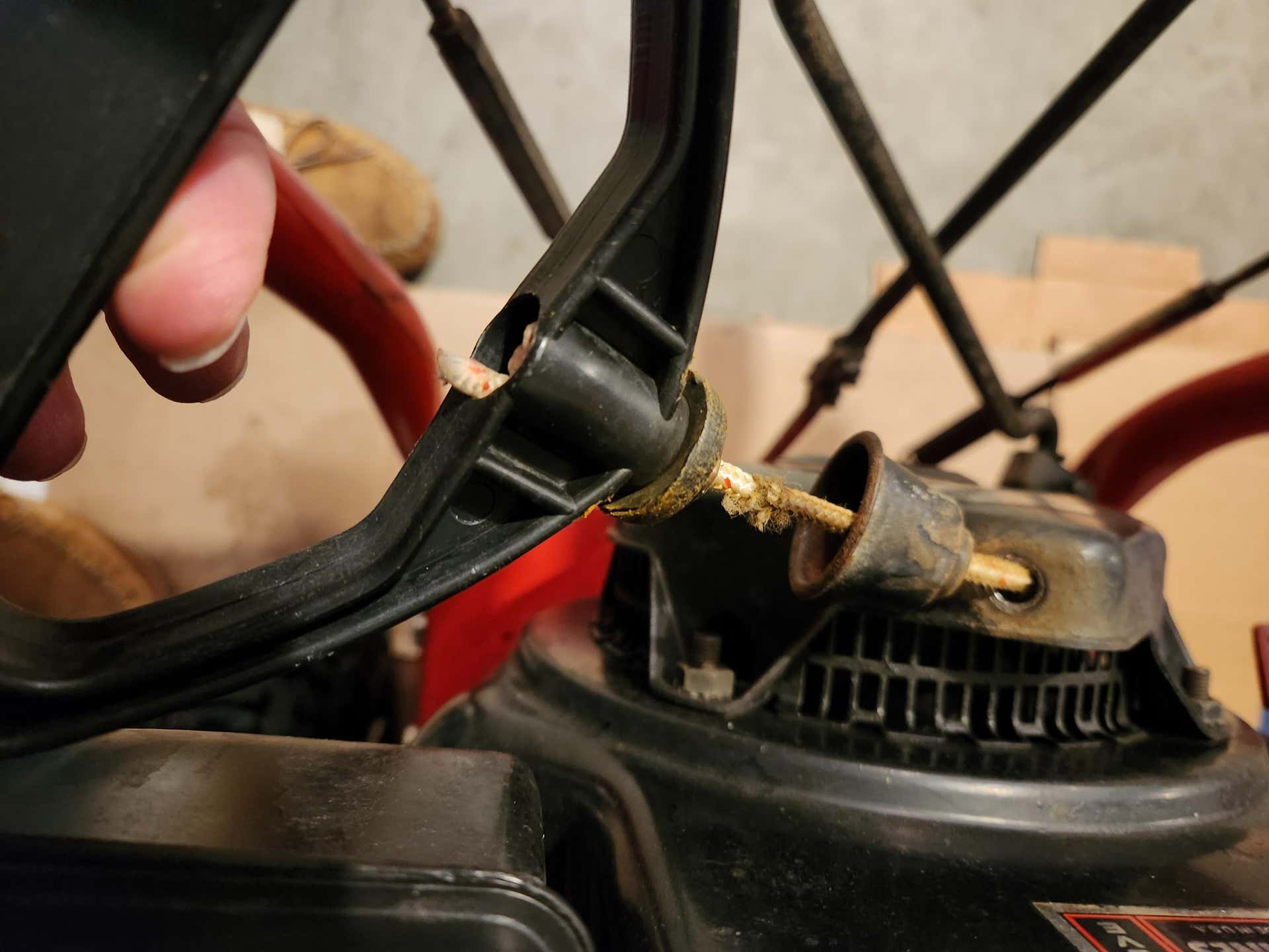

I have a Troy Bilt 2-stage with 8 HP Tecumseh engine. I use pull start only. The pull cord handle retracts into a metal bell-shaped recepticle that used to be fastened on the top of the recoil shroud. The bell has come loose and I am concerned that its absence will lead to excess wear and early failure of the cord.
I am not a welder, but understand that it can be very tricky to fasten several thin-walled steel things together because they will not stand up to the necessary heat. So, shy of replacing the whole recoil shroud, what would you suggest to repair this? I was wondering about just putting a heat gun on both pieces to warm them up, then goop a bunch of J-B Weld around the base.

They are press fit. Clean it as it was suggested. Then1 coat of jb. Then a 2nd coat and wrap a mesh around it. Screen door material works well. Then a thin 3rd coat.

Tack weld or JB Weld Epoxy.....however likely not a concern to just remove if there isn't a sharp edge on the remaining piece. A dremel rotary tool or similar should clean/prep up that metal for a good and proper bond.

If you are going to JB weld it, You must remove the dirt and loose rust first. A minute with a small wire brush will do.

Well, lacking the metalworking skills necessary for welding or brazing, or a trustworthy soldering, I opted for the reinforced JB Weld repair.
The broken pull-handle "holster" was actually a pressed-in fitting, but clearly irredeemable.
After a full cleaning and scuff-sanding, I tacked things back together with a small amount of JB and let that harden overnight.
This was followed by several wraps of coarse steel wool which was densely impregnated by JB. Wipe a fresh surface coat of JB & let that setup overnight.
Sanding, painting, & good as new. Actually, probably better since this reinforced JB Weld should last longer than the metal it is attached to.

I hope you did not remove the base of the cup. It protects the starter rope from fraying as the rope moves in and out. Without a smooth opening, you will be shredding starter ropes regularly.
#26 ·
Nope - I thought I may need to fabricate a JB "chute" on the inside to keep the rope from fraying. But the original base was still in good shape, so I just tacked it in place with the first coat of JB and the rope should be fine.
